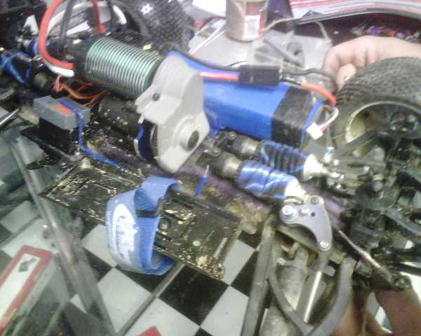

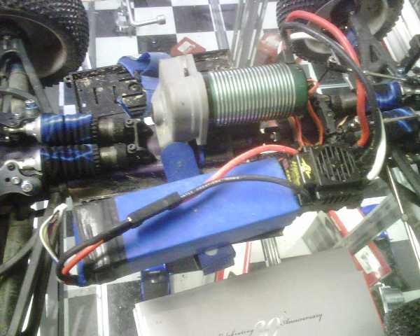

Here is my revo MT/Truggy. Perfect weight distribution....
Tranny is set backwards for the motor to hang forward to hang the weight towards the front. With twin 3's its perfect 50/50. Truck runs 39mph on 3S and after 30min run, the motor is 110-115 and ESC is 101-105. Awesome setup....weighs 9.5lbs exact without batts.
