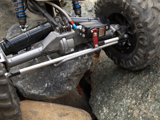

Yep you heard right
Scale super Rock crawler single engine
Hand made Chassis, MIG welded 1/4 .035 wallstainless steel tubing
Custom angled solid stainless steel axles
Axial Transmission
Revo drive shafts
Losi after shock Center Diffs, with custom made lockers
Hyper 8 drive axles
Madforce hubs
4 Wheel steer
2 wd and 4wd and rear dig with custom mechanical DIG setup
4 link suspension front and rear
Delrin Acetal Links
HDPE bottom Skid
Polycarbonate side body panels
Stereo
6 watt Altec Lansing speakers x4
Sony MP3 player in dash , 3 tone LCD lists songs
Plays real V8 engine sound
55 Turn Brushed for Crawling
BM16 1005KV Brushless for Rock racing
Batteries pictured are 8 cell 4500 Nimh, Recently Replaced with 3s Lipo 2250
Weight with Nimh is 12 lbs, so with Lipo it will be about 11
Drive time about 1hr 15min
Wheel base 18"
width 14"
Spectrum DX6 radio
HItec 5995 Front and rear servos
Mamba Max ESC
Castle BEC
DIG servo
I am very pleased and amazed at with the outcome and climbing
Crawls Great but weak spot is the tires
I know there is more details
Let me know if you have any questions
Start to Finish Build thread in my SIG below, LOTS of Pictures
