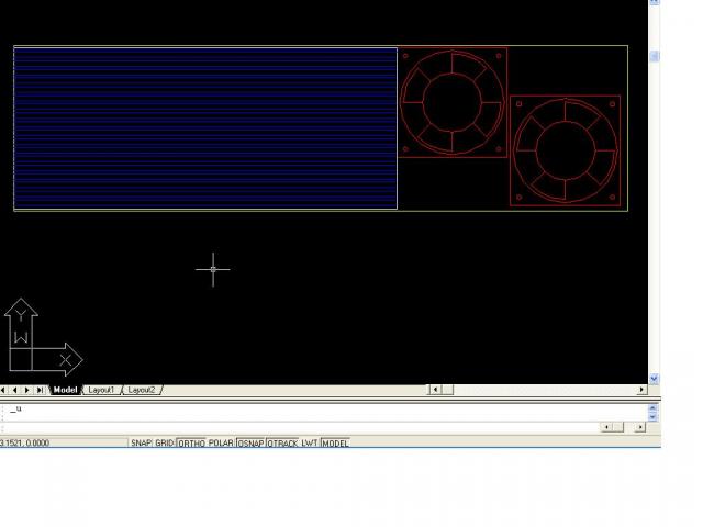

That's exactly how I have done my heatsinks and it works great I just used 1 at the end that was a 4 5/8" square fan thermister controlled (ended up just shorting it out because it just wouldn't run fast enough for the application). Mainly a fan at 1 end because it's easier to bend. I have a ACAD pic I drew up but I can't remember how to capture a screen shot(edit: nevermind). I have it setup with 2 fans on 1 end.
As far as constant current you must add in the more parrallel resistance in order to keep the current constant. You could use a window comparator to turn on a fet or relay to switch in more resistors. I have a line on some .001 or .01 ohm resistors that are like 100W or 75W same style but bigger.
