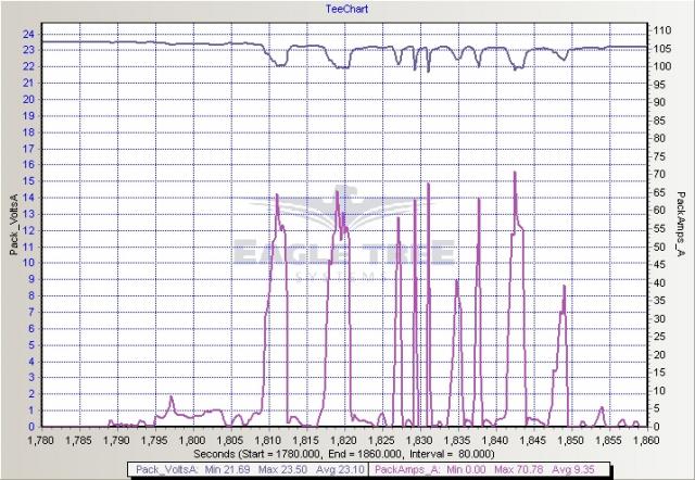

will be updating this thread as i get new data.
first test today.
rEvo conversion, 3905 tranny, geared 17/65, 17mm talons, traxxas stock CD
Turnigy 6s 5000mah 30C pack
put as much power down as i could without wheeling or unloading the front too much.
need to pull more amps to get real data for you guys but this is just an idea of what we are dealing with.
more data when i hot up the setup more, comments and vs against high end packs welcome!!
