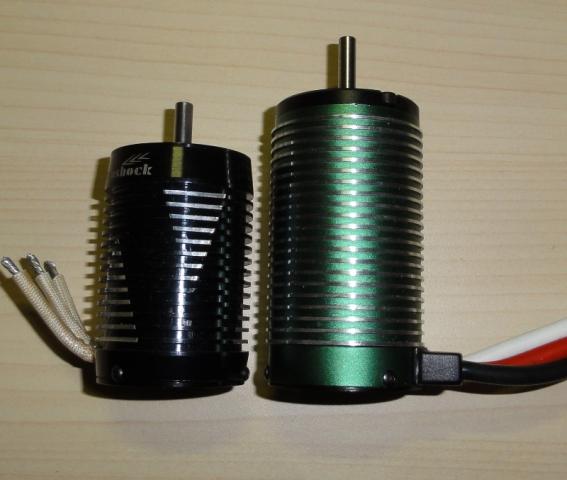

We have currently about 6 of those running and they are doing more than well !
Very ESC friendly and
The Test with the CC2200 KV against the 2240/7 same KV running an AE SC8
was a win for the 2240/7 even on 18/46 gearing
in
runtime
temp
power
On MMP
CC 2200
Runtime: ca. 16 min.
ESC ca. 52°
Lipo ca. 41°
Motor ca. 53°
TS 2240/7
Runtime ca. 16 min.
ESC ca. 48°
Lipo ca. 37°
Motor ca. 44°
Lipo Kokam H5 5000 mAh (older one)
Same gearing 16/46
No datalogs yet need to get the Eagle Tree working
