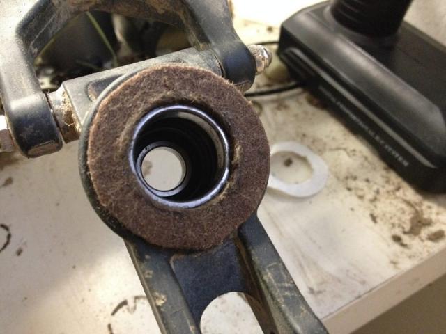

Thanks guys. It is a blast to drive. Despite the weight it is still a very sturdy platform. Not much to wrench since around 28 runs. Only the bearings in the rear wheel carrier can get stuck when i drive in the wet ... aside from that nothing.
I have now protected the bearings. Let's see if that helps.
