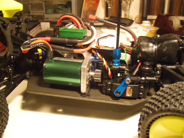

IT'S ALIVE
I just got it done to late to drive it but everything works. :018:
I used the ESC off my CRT so the UBEC was wired in so I decided to leave it makes it easier if I want to play with a 4s lipo later and I like the extra voltage to the servo.
Anyone thinking about this conversion you can probably use the RC Monster motor mount for the Jammin buggy to convert it with a couple of washers under the front diff mount to level out the center diff it will make it alot easier to get the motor mounted up. :)
