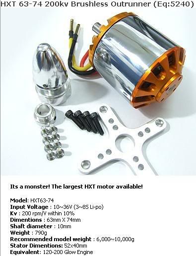

Been thinking about this idea from the very start of my save for a 5b. I should be able to finally purchase it this weekend or next week sometime. Ive seen my friends 27cc grizzly run and its a beast for sure. Only problem is that my neighbors hate the extremely loud setup he has. "Xcan pipe with 27cc engine". Im looking to possibly convert my 5b. I have the Sentileon 100a HV ESC set to order whenever I get around to ordering the 5b and I also have my mind set on The white lipo packs from UH that have are 5s 4800mah 25c-35c. I plan on running two in series. That should be enough for that but Im stuck on a motor.
Heres what I had in mind...
Keep in mind that a normal max rpm range for 23cc-28cc 2stroke gas is 10k rpms. The outrunner has 250kv. Take 250kv x 37volt nominal and you get 9250 max rpms. Plus this motor has a 50-70cc 2stroke gas equivalency which should be plenty of power.
So the setup will be...
ESC- Sentileon 100a HV
Battery- Two 4800mah 25-35c 5s Lipo's
Motor- HXT 80-85a 250kv Outrunner
What do you guys think.

Hmmm... When I buy the 5b either on monday/tuesday or wednesday this week Ill see if I can put an order on the motor and the ESC. That way I will not be able to change my mind on this seeing that Ill try to many times. I still have to see what Im gojng to use for a motor mount. Im thinking .50in tempered plexiglass 12x12 sheet off ebay for $20. The main think Im worried about is the burst current draw from the giant outrunner. If I gear it just right hopefully it wont try to draw more than 150a cont otherwise my lipos are screwed... If you guys have any suggestions please let me know.

Ok I think Ive made up my mind on this. I will order the Sentieon 100a HV ESC along with this outrunner... The reason I want this one over the bigger purple one is that its half the cost and has a better quality rating.
Its a little less power but in my opinion on 10s it will be plenty for my likings.

is there even such a thing as tempered plexiglass?
why not the 80-100
