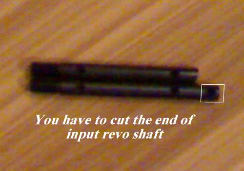

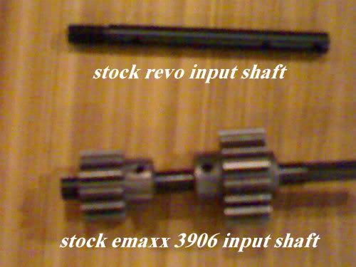

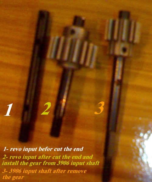

and you can convert your tranny to gorilla single speed with revo input then you can use the new e-maxx spur style just like me.

ok its very easy if you have gorilla single speed.
here is the revo input http://www3.towerhobbies.com/cgi-bin...?&I=LXHGE1&P=7
and you must have 3905 slipper
http://www3.towerhobbies.com/cgi-bin...?&I=LXHGC5&P=Z
http://www3.towerhobbies.com/cgi-bin...?&I=LXTKK8&P=Z
http://www3.towerhobbies.com/cgi-bin...?&I=LXTKM3&P=Z 62T
http://www3.towerhobbies.com/cgi-bin...&I=LXKLZ9&P=ML 58T
http://www3.towerhobbies.com/cgi-bin...?&I=LXVCX9&P=7 24T
