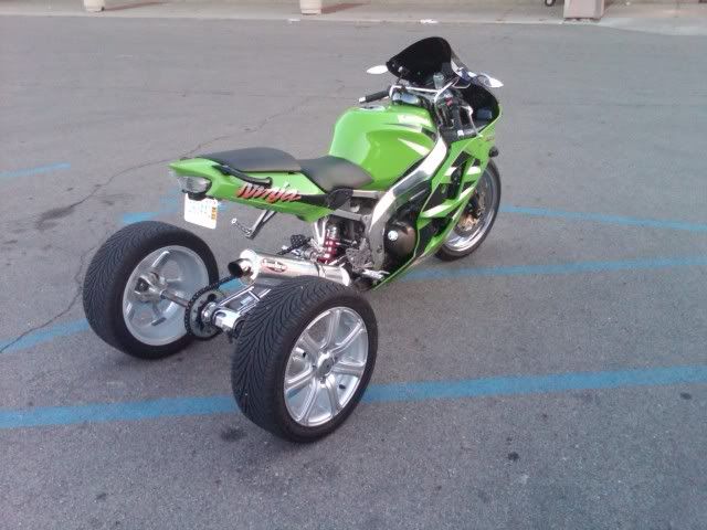

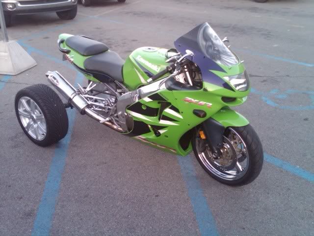

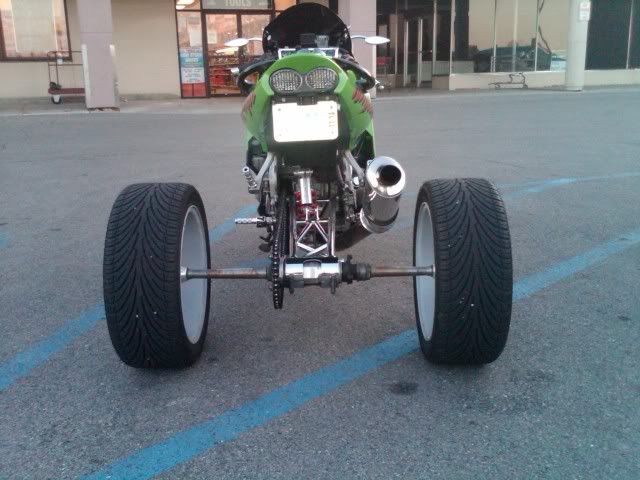

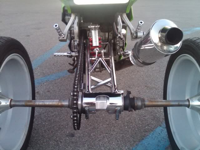

Oh, I checked out yer page Redshift... cool bikes! I'm not a bike owner, but they are bitchin. I saw this Kaw Ninja Trike conversion the other day in a dept store parking lot. I took pix of it on my phone. It was something else! It looked really mean! I think it had a chain drive. It was slick!

Ok, I think I can post these here since it's a "General Discussion". Here are the Ninja pix! (and yes, I was at Harbor Freight! HA!)

Not sure if I like the trike... But it is different that is for sure! Looks like they took the design of a chain drive 4 wheeler for the rear swingarm. Someone put some time into doing it that is for sure.
I had an almost identical bike to that, save it was a 900cc. Nice bikes, rode very well and was quite comfortable for 2 up riding. Actually had 2 of them, a 99 and a 2000. Now I have a 2000 12r, not as comfortable, but much faster/quicker!

I have to agree. zx9's are comfortable. I had a 2000 gsxr750 and it was comfortable for a sport bike but now that I am a little larger I dont think it would fit me as well.

Nope. Like the work, but you don't take the bike out of a bike. Because then it's not a bike, and you don't have a bike. And well, it's just not a bike.
A full chicken-strip tire is for old men, and trikes are quite dangerous in many ways.
Great for Mr. Jurassic on his Goldwing, but not a sportbike!
Like a Lamborghini with pontoons....
