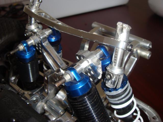

Hi guys my supermaxx cvds 8mm axle broke
is there a alternative replacement i can use.
i have ue spider 8 diffs.
could you please advise.
Cheers.

Where did it break? Pictures?

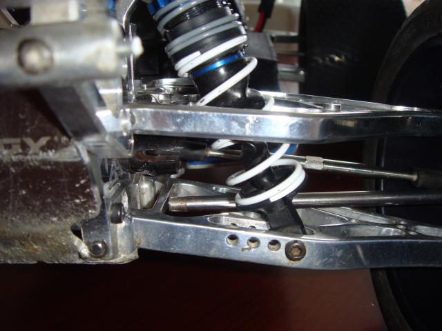

right next to the diff cup
i have attached a pic
do you have one spare also do you have a racer x shocktower as well
broke both

You can use Jammin' X2 truggy universals in place of the UE 8mm cvds, this will also allow you to use a 17mm hex. You can get them off ebay pretty reasonable. I have both and am currently using the truggy universals. I hope that helps.

Both x1 and x2 CRT unis and hubs(gray or blue will work) will fit the racerx/EXT suspension.
