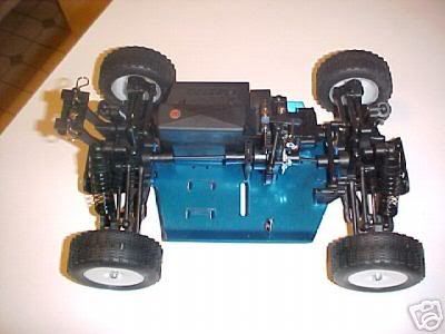

Ok, so I bought this off e-bay for a good price:
http://www.sportwerksrc.com/Products...ProdID=SWK1400
I am going to go brushless with it and wanted some input on an ESC
A. Mamba 25
http://www.castlecreations.com/products/mamba.html
B. Mini Tazer
http://www.horizonhobby.com/Products...ProdID=DYN4930
C. Quark 33 or 22 amp
http://www.b-p-p.com/proddetail.php?prod=ea_Quark33Car
http://www.b-p-p.com/proddetail.php?prod=eb_Quark22Car
I am thinking of using this motor
http://www.b-p-p.com/proddetail.php?prod=dg_Align
or this one
http://www.b-p-p.com/proddetail.php?prod=dz_permax400
I plan on using a 2 or 3 cell lipo
What do you guys think? Am I on the right track.

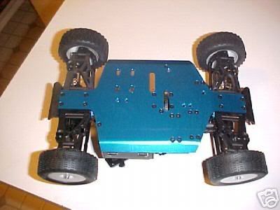

12.29.2007, 12:27 PM
If found it in ebay for $78,87.
It has a wide alu chassis, very nice for electric conversion.
Do you know what pitch is the spur gear? 32p or MOD1?

Team X
12.29.2007, 12:46 PM
This is the cheapest I have found it
http://cgi.ebay.com/SPORTWERKS-CHAOS...QQcmdZViewItem
I tryed to e-mail sporkwerks about the spur gear pitch, but they have not gotten back to me.
What are you going to use for a motor mount?

VWT4
12.29.2007, 12:54 PM
I think the Mini Quake's motor mount will work.

12.31.2007, 05:27 PM
just fyi, i was reading a bit on rcu about these and people are stripping the diffs with the stock .05 motor. you're probably going to see some issues with brushless power. there is a question whether on not the irc gears will fit. they have a metal gear upgrade.

VWT4
01.10.2008, 01:43 PM
I measured the spur: it's 32 pitch.
