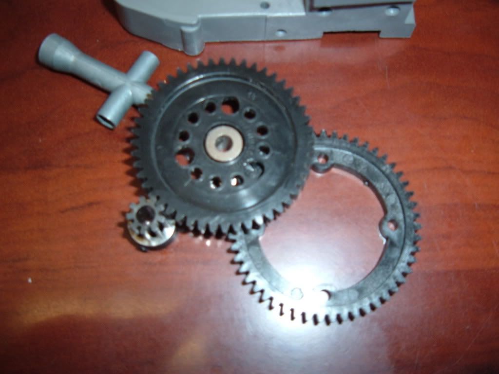

You can also use mgt spurs, but they need a little modification to fit. They are mod 1 and require a 5x10 bearing instead of the stock 5x11 bearing. They come in most sizes from 46 to 52 tooth.

You have to enlarge 3 of the small holes to 5mm to fit the revo spec slipper mounts. And you can either enlarge the center hole to 11mm to fit the stock bearing, or use a 5x10 bearing that is slightly oversize. I usually just file fit the spur to fit the 5x10 bearing.

Mgt spurs are mod1, tower is wrong.
Here is a pic of what a modded mgt spur looks like. I think that the center is enlarged to fit a 5x11, but a 5x10 bearing is much easier to use.
