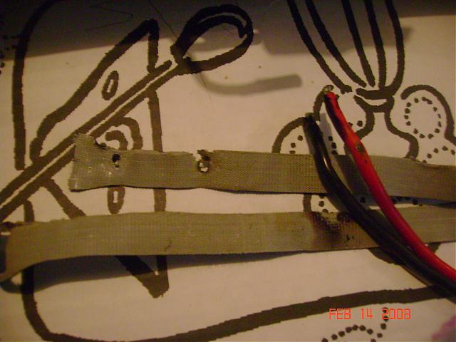

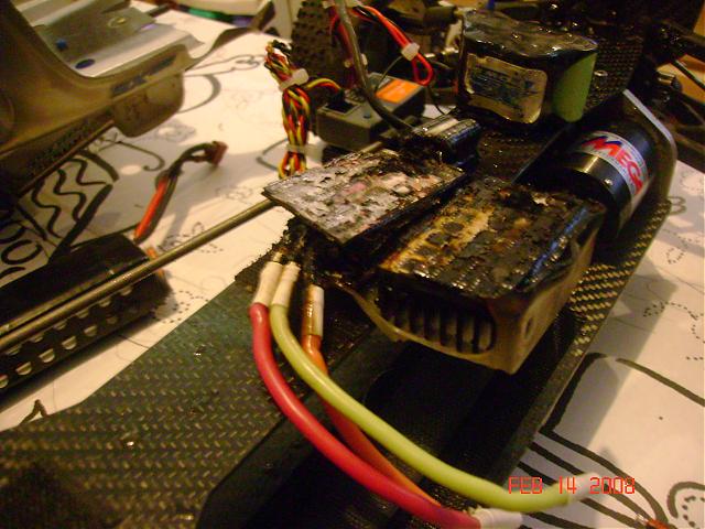

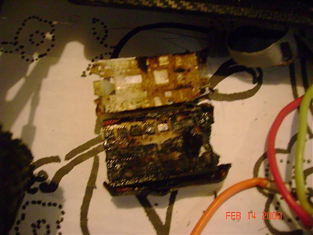

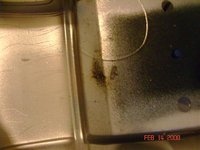

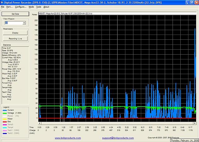

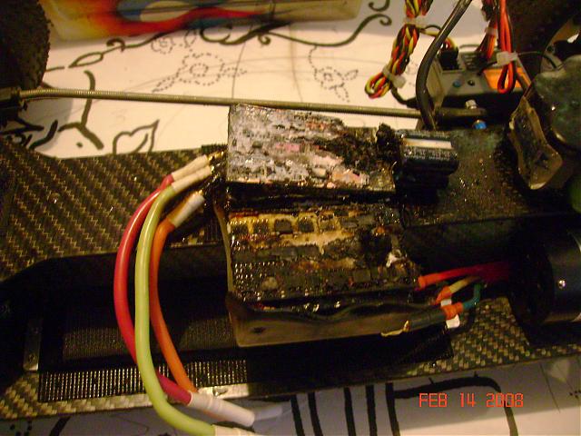

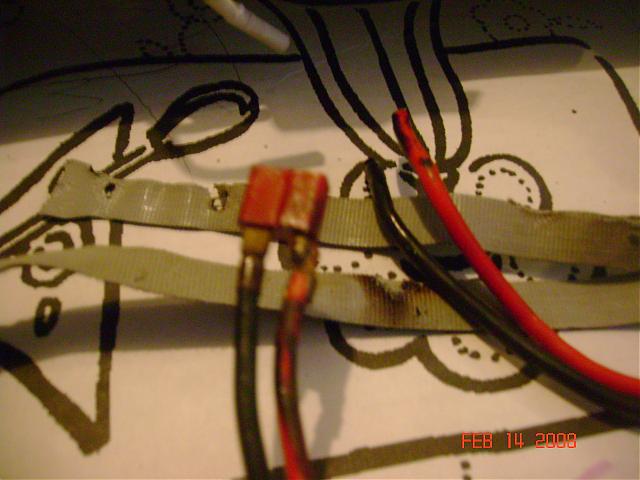

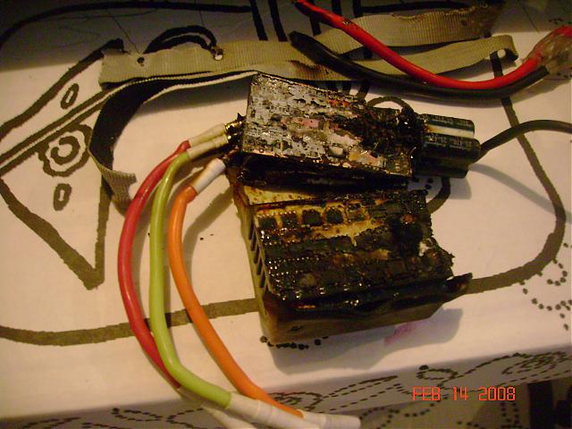

Let me explain what happened . I found a nice dry spot to run my MBX5T. I was going to run it until my 2200mAh packs didn't have more juice in them. Everything was running very cool since it was 38 degrees and you can also see in the graph I stopped a few times to make sure nothing was over heating. I did a feel full throttle passes and on one pass I slammed on the brakes and did a nice little slide. The truck rolled backwards and I applied some throttle to get it rolling again and smoke . That's when I didn't hesitate and went running towards the truck took the body off and unplugged everything. The flames happened very fast and you can see it almost burned the body and the wires from one of the packs. The Velcro straps melted in a couple of spots. Man, I was loving this controller as all I heard from others was the horrible stories of it catching on fire. So if you have a Schulze and your vehicle rolls backwards, don't hit the throttle. Wait until it comes to a complete stop .

The fire happened fast too. I've had ESC burn on me, but it was usually just smoke. I was able to get the body off fast enough and I kind of tilted the truck so the flames and any hot stuff would just fall to the ground. I actually saw that the copper traces was red hot.

This is by far my worst case. It stinks as the truck was very fast and the most AMPs it was using was around 75A spikes. The last when the fire happned the darn AMPs went to 182.

Mine is basically like that. In the pictures, you can see the heat sink is only there because of the shrink wrap. The smell is what drives me crazy. I'll see how well my BK 9920 will drive the 6 pole Mega.

I'm also extremely happy that this little 2200mAh packs held up. Man 182A should make any other battery a little hot. This little guys stayed cool.
