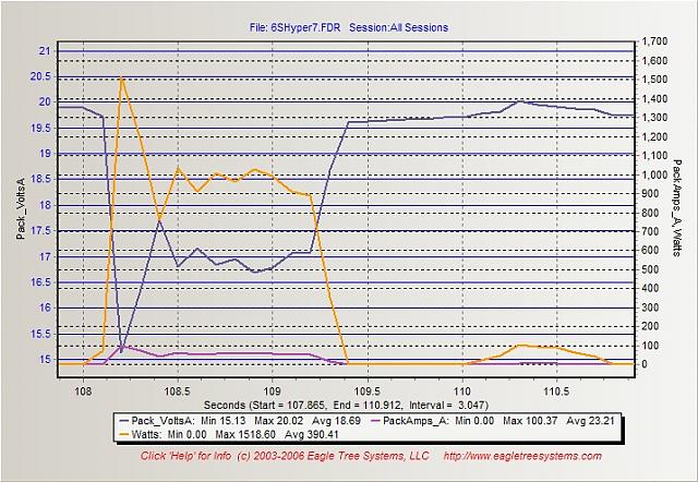

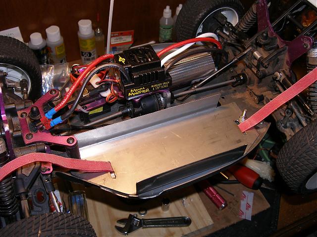

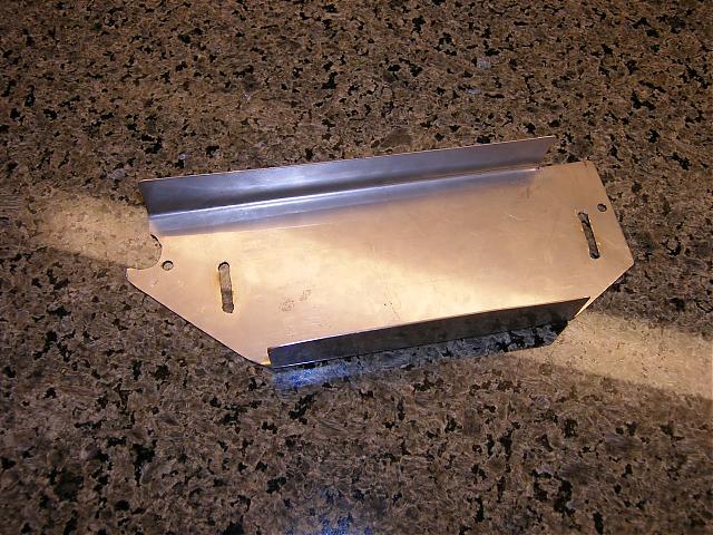

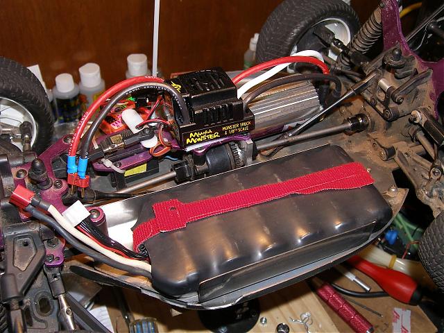

Finally finished the battery tray so now it's actually road-worthy. Made a run with the eagletree too, the 6S1P pack works pretty nice. It's geared 13/46, so it's running about 35 mph or so. Blistering acceleration, from a dead stop I can make 5 - 6 houses down the street in about 4 seconds.
