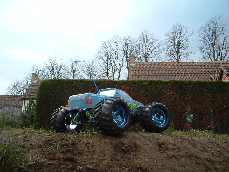

Well I got to admit, yes I have spent a lot of time and money on it, lol. It is the only RC I have, but I'm pouring most of my time and money in to it...and when it is "finished", then I'll buy another RC, start modding it, etc. Of course I'll still drive CF a lot.:) Anyways, here are a couple of pics:
Basher shell:

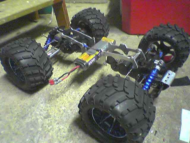

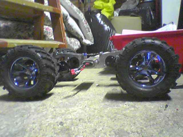

I'm afraid I haven't got any remotely up-to-date pics of the truck with the shell off. But since the list of mods above, I have modified the rear diff to accept a TNX spider gear (so it's now bullet-proof), put in a 30,000uF power cap system, re-built the truck several times and put in 70WT shock oil. But the main thing is that I have been *intensively* modifying the chassis to be lower and lighter. Here's a pic (sorry about the quality):

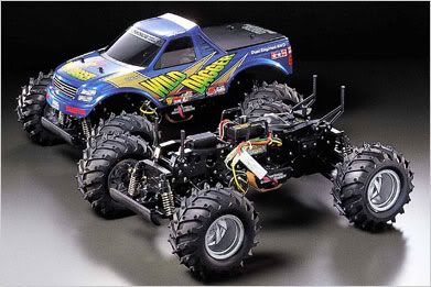

Sorry for the loooong post...thanks for looking tho mate. :) Oh and here's what a stock Dagger looks like:

That looks awsome, great job!

That is a big difference from stock to yours. It is nice. Keep up the good work. Thanks for the pics to. I like that gmc body. Looks like a crowd pleazer. I like them to. I have to go threw some more older threads. See if I find any more cool projects like yours. I sure wish I had found this place earlier.
