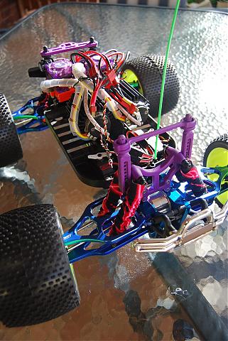

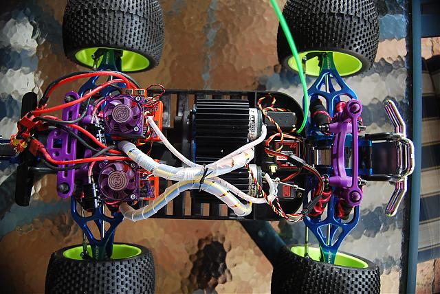

Hi guys, I'm new here. read thru a few treads and very impress with all the mods seen. I need more infor or ideas as to how I can make more out of my Emaxx. Gorillamaxx G3 carbon is in the budget, maybe flextek arms. Cannot decide on motor yet, Neu?? Lehner?? ESC? MMM or MGM. I have A123s coming total up to 7s 4600mAh. Please take a look at my truck and any suggestion on which direction I should go? Transmission??

You could do like most of us. Your truck looks like a piece of work. Have some fun playing with that one while you build a new one that is more powerful, stronger, and even more impressive. I think most of us started out with Integy and Novak stuff in the begining with the EMaxx, but once you find out about some of the other gear that is available and how much better the quality isthe sky is the limit. We all have a kind of thurst that must be satisfied. The good thing is that as time passes more and more quality stuff is comming to life. Do your research and decide what you like best. There is information in here that covers just about everything that you can imagine. Good luck with that.

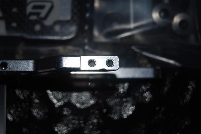

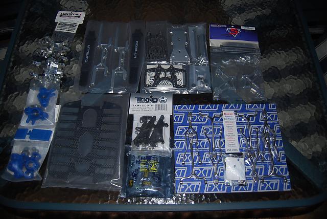

parts are turning up for my Gorillamaxx build. Still some more to come. Just a small dent on the X-brace nothing a file can't fix.

There are a couple maxxes and revos with center diffs fitted, or being fitted, but unless you can make your own its a difficult route to follow:
V2 slipperential
FLM chassis center diff unit
MaxxBling
I would stick with an upgraded 3906 tranny really. For a motor, either a neu 1515 item, or lehner 1950, maybe even hacker C50XL, depends on your budget really. Seeing as you have enough A123 cells for 7s2p I think, the MMM would be fine (wait for 2nd gen to arrive in a few weeks time), or wait for the tekin Rx8 to arrive. You wont be short on power at anyrate...
