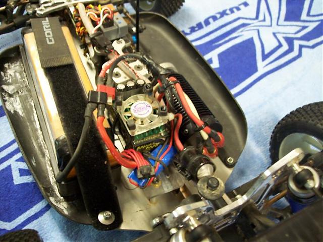

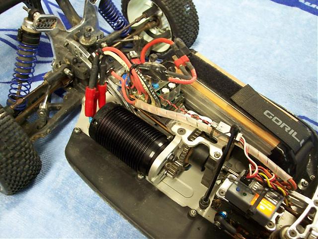

well i got my Neu 1515 2.5d /f from mike yesterday and finsihed getting it installed today and HOLY CRAP why didnt somebody drill it in my head that these motors are worth every penny, i just finished my first run. It ran for just over 26 minutes (16.5v cutoff) !!! this is just non stop rompping on it and hitting the brakes hard, as to resemble a race, which i dont guess is accurate because am a much smoother driver on the track rather than a punch and brake driver.
im geared for 38mph, with a Mod1 MM, startpower medium, timing on 5, 0% drag brake, 60% brake (custom curve), 0% punch control (nice curve pulled down at 20 and 30%), 25% reverse, 16.5v cutoff, cc bec, 30mm novak fan.
temps at 5 minutes were:
neu-110
Mod 1 mm*- 118
FP 5s 5ah - 105
at 15mins:
neu- 121
mod1 mm*- 127
FP 5s 5ah- 110
and at 26 minutes! :
neu - 130
mod1 mm* 137
fp 5s 5ah - 112
*= mm has 30mm novak fan on it (but is missing 3 blades lol)
im charging the battery right now so i can get one more run before dark

Glad the motor/ESC mounts are actually working out . I wasn't sure if the ESC mount would hold up, but it looks like Shaun's addition of the standoff did the trick.
rootar
rootar's Avatar
Posts: 1,803
Location: arkansas
08.05.2008, 08:25 PM
actually metalman the wire you had glued to the bottom came off, and so did the post, along with shauns battery tray lol but the i think the esc plate needed the extra flex, and so far so good since i went through and locited everything.
btw that motor mount is PERFECT the finned neu just barely sits above the chassis, so its as low as possible without actually sitting on the chassis, plus the whole thing is super thick, which is good insurance for supporting the 1515 with mikes front and rear covers (3inches long!)
