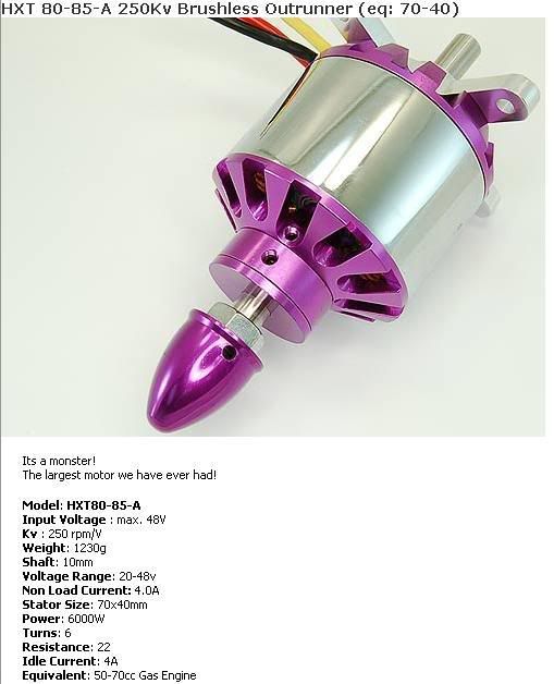

Been thinking about this idea from the very start of my save for a 5b. I should be able to finally purchase it this weekend or next week sometime. Ive seen my friends 27cc grizzly run and its a beast for sure. Only problem is that my neighbors hate the extremely loud setup he has. "Xcan pipe with 27cc engine". Im looking to possibly convert my 5b. I have the Sentileon 100a HV ESC set to order whenever I get around to ordering the 5b and I also have my mind set on The white lipo packs from UH that have are 5s 4800mah 25c-35c. I plan on running two in series. That should be enough for that but Im stuck on a motor.
Heres what I had in mind...
Keep in mind that a normal max rpm range for 23cc-28cc 2stroke gas is 10k rpms. The outrunner has 250kv. Take 250kv x 37volt nominal and you get 9250 max rpms. Plus this motor has a 50-70cc 2stroke gas equivalency which should be plenty of power.
So the setup will be...
ESC- Sentileon 100a HV
Battery- Two 4800mah 25-35c 5s Lipo's
Motor- HXT 80-85a 250kv Outrunner
What do you guys think.
