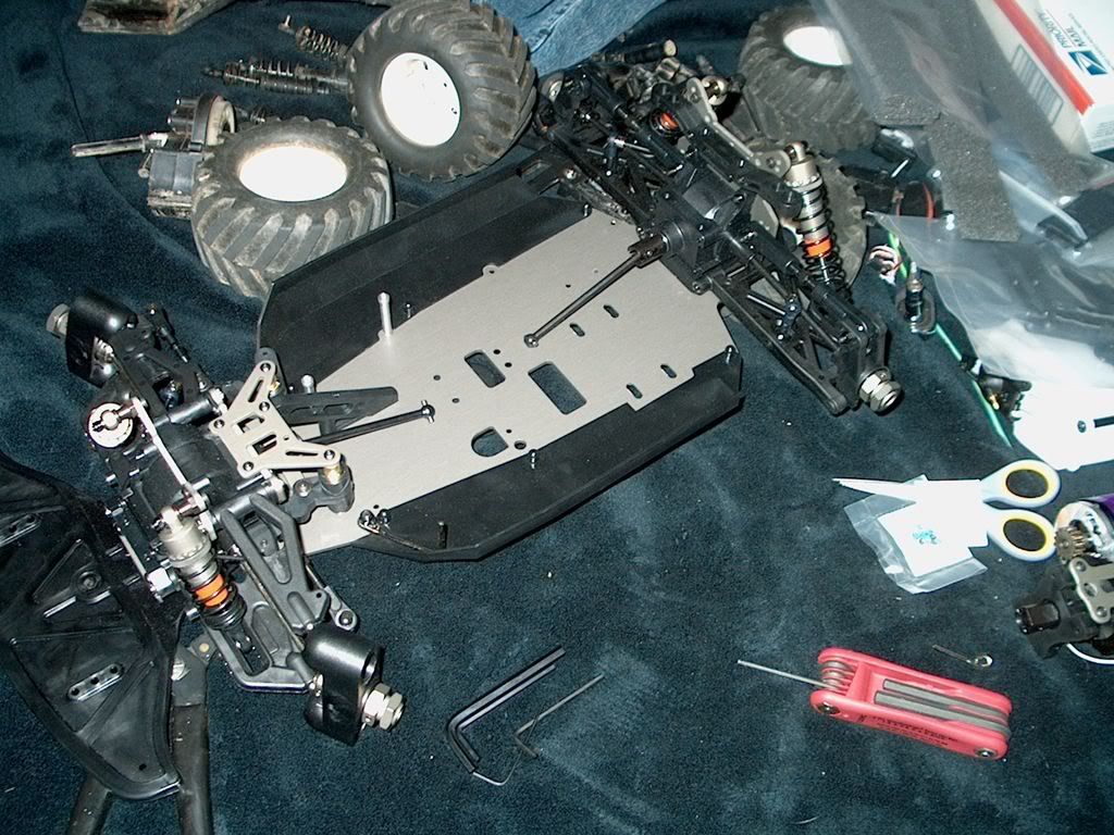

08.26.2008, 09:39 PM
Got the GTP, and the stuff came from Mike!
Got all the nitro stuff removed, installed the RCM mount and pinion, along with the C50-Maxx.
Pics:

08.26.2008, 10:42 PM
Make sure you shim you fr and rr diffs. My rear ring and pinion is getting a little clicky.
"If yer not 1st,yer last"
OFNA GTP w/Quark-Medusa 60mm-5s
Inferno SP2 w/MMM-1512 2.5d-5S
Inferno St-rr w/MMM-1515 1y-5s
08.26.2008, 10:50 PM
Very true, Hongnor k series diffs (most ofna vehicles save for the hyper line) are not the best, and require a good shim job...
