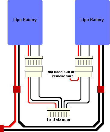

Hi everyone,
I've got 2 x 2 cell packs which I would like to charge and balance from one charger to save time (as a 4s). Is this possible or will it damage my packs? I have got a series connector to charge them at the same time (connected in series for running) but is there a balancer lead for a Hyperion LBA10 that has a lead for each pack, that would register on the charger as a 4s?

It works fine but both packs need to be at the same level / charge cycles (ish) to work right.
I do this for my 4s setups that use 2x 2s packs - I think briang has a script for this...

So it would wire up like this:
Seems simple enough, time to go and buy some connectors! Oh and no its not raining which is a suprise, did you used to live over here?

Like this pic...

Ah, about half an hour from me then, I live in Stockport. Thats the diagram I meant to post, not sure why it didn't work. That All e RC place seems to be pretty good so far!

I have to update the program. The link it told you to post is just a hyperlink, not an image link. The old program used to assemble the proper diagram image from seperate images and called a seperate page to re-assemble them correctly, so there wasn't a single image URL to post. Now, each image is seperate so posting is easier. I just have to update how the "get picture" button works. Sorry.
