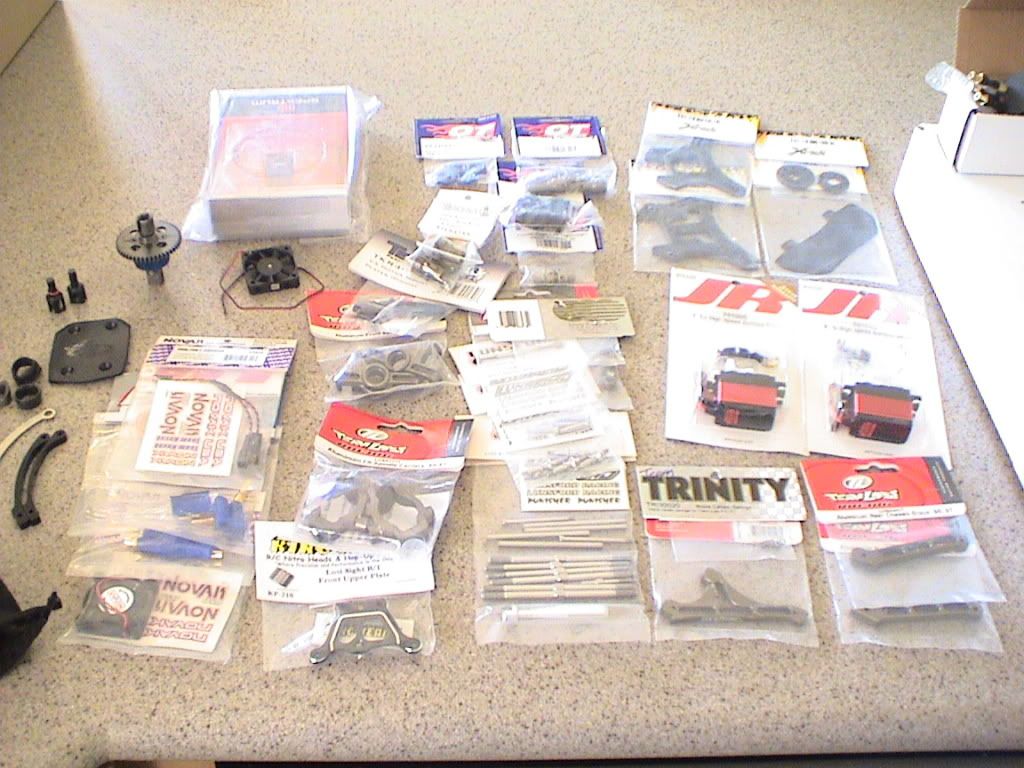

so i got most of my ordered parts yesterday and started the build today. i have a couple of other parts coming thursday so i should be able to finish in time for the weekend races.
i am going all out on this one. this is basically the same setup as my 8 buggy but this time i wont be going off trial and error. here are the hop up/conversion parts:
Tekno Rc V3 electric conversion
Neu 1512 1.5D/F
MMM modified
5s Thunder Power V2 lipo 5000mah
Lunsford titanium screw kit for losi 8t

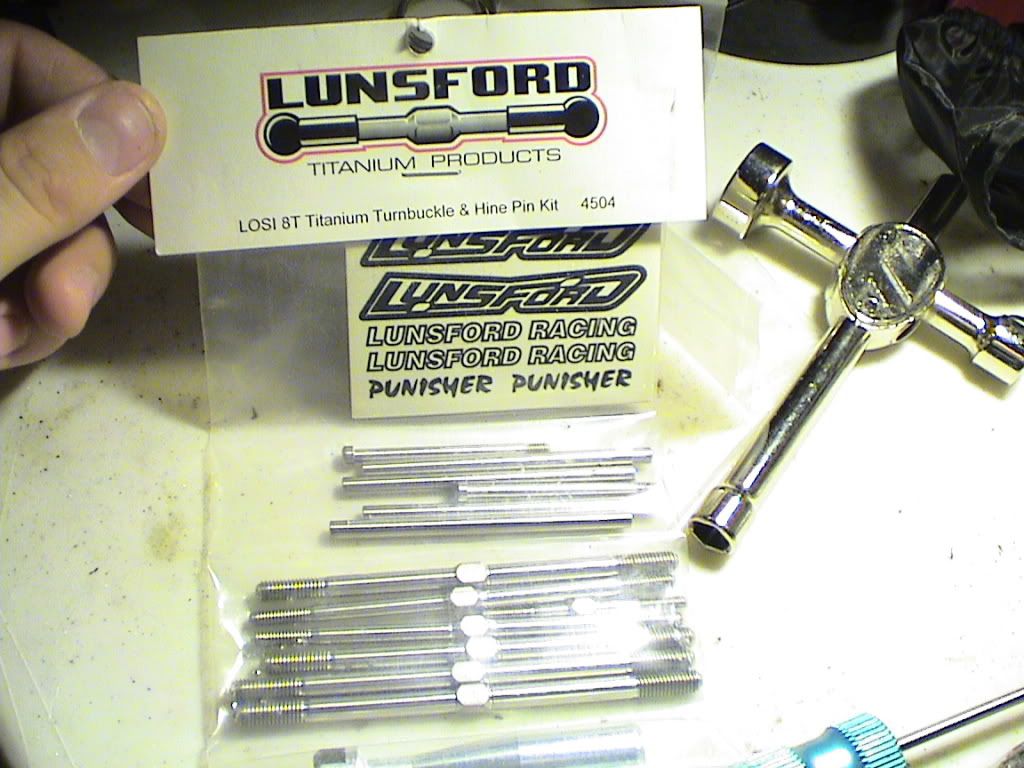

Lunsford ti. turnbuckle and hingepin kit
Lunsford ti. king pins
Acer racing ceramic nitride bearing kit for losi8t
Tekno 13t long shank pinion
Fioroni Tractive IV front and rear diff
RobinsonRacing wide/hardened spur for center diff with lightened outdrives from Losi
Losi front/rear alum chassis braces
Losi alum spindle carriers
Losi alum front spindles
Fioroni rear alum hubs
Fioroni lightweight driveshaft axles
Fioroni lightweight pinion couplers
Fioroni "grip" wheel nut
Xtreme Racing carbon fiber front/rear shock towers
Xtreme Racing carbon fiber disc brakes
Xtreme Racing carbon fiber mud guards
King Headz alum top plate
high downforce rear wing
JConcepts rulux half ups LPR wheels
Proline holeshot LPR tires
10 ga wire throughout
lead free silver/tin solder
JR Z9100s servos for brake/steering
Spektrum DSM2 3 channel rec. 3100
Losi alum servo saver
Dragon Racing (ebay) hardened driveshafts front/rear/center
losi brake springs
dynamite brake linkage kit
Though i have added weight with alum. parts in a couple of places i wanted that extra strenght plus i have saved weight with titanium parts/screws instead of steel and also with the lightweight pieces from fioroni and others. the acer bearings are lighter than stock. the ti. screw kit cuts out about 3-4 ounces.

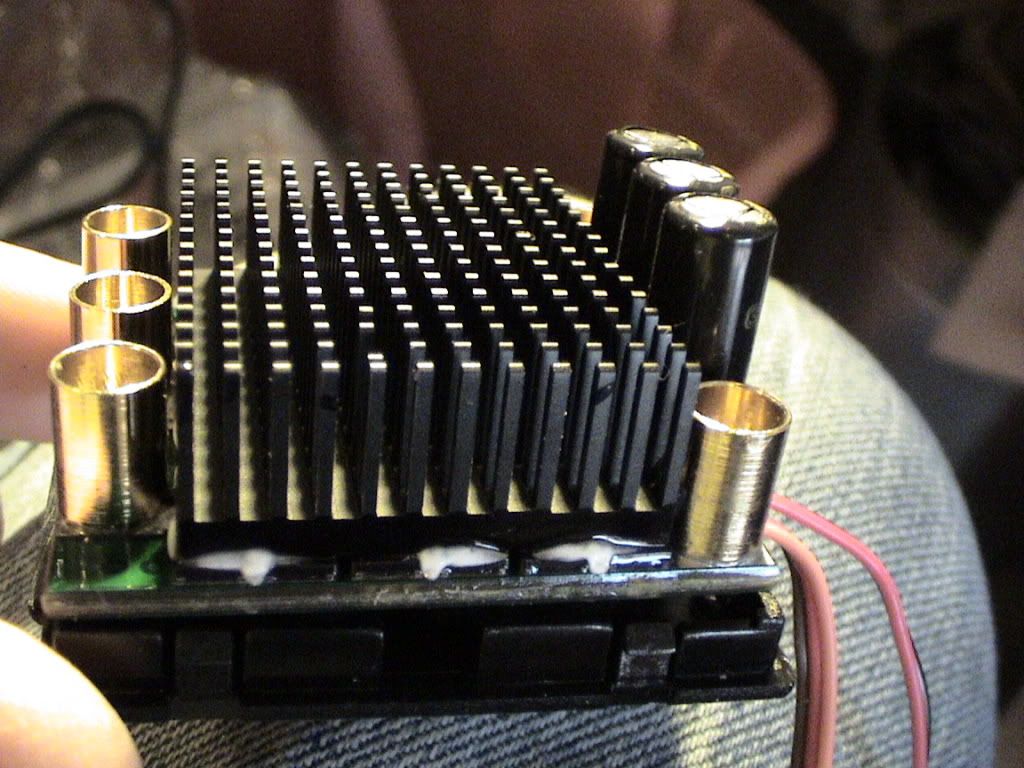

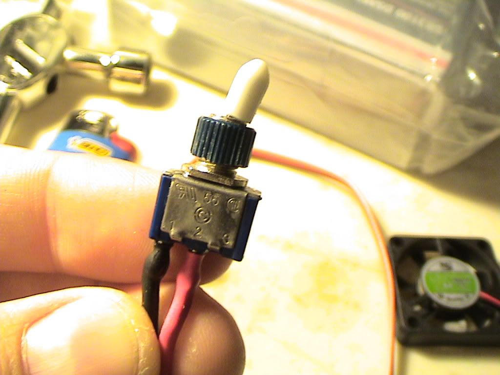

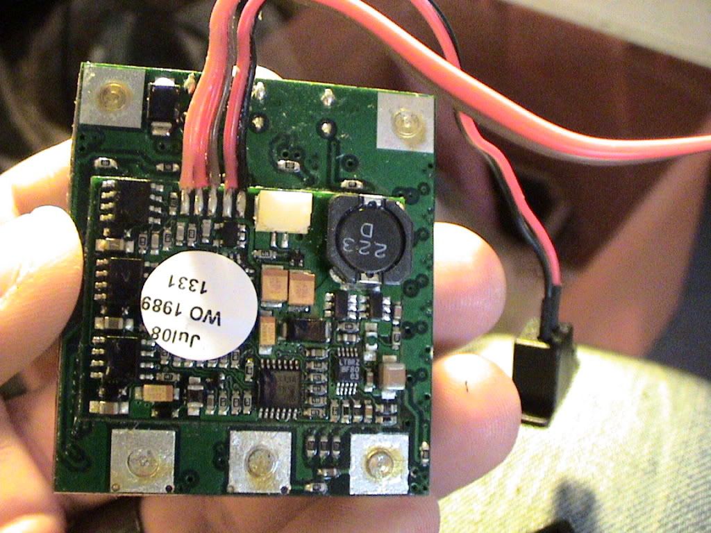

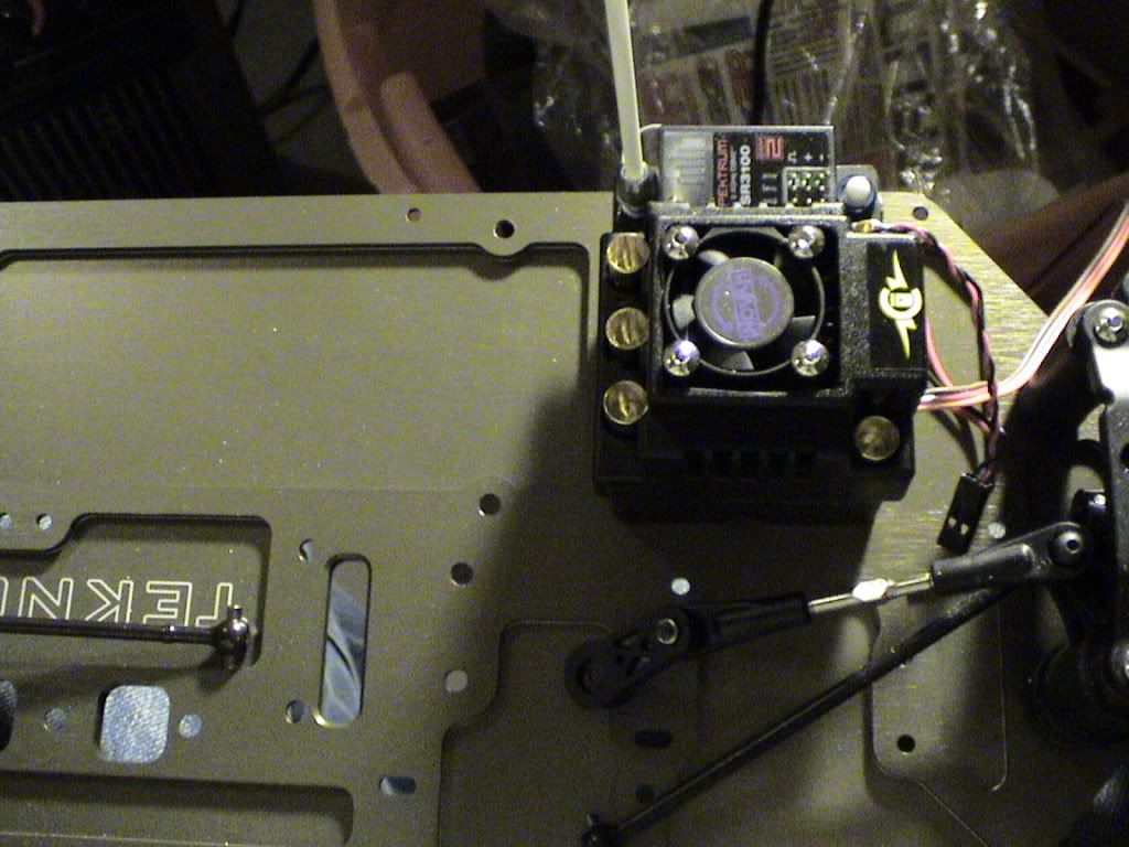

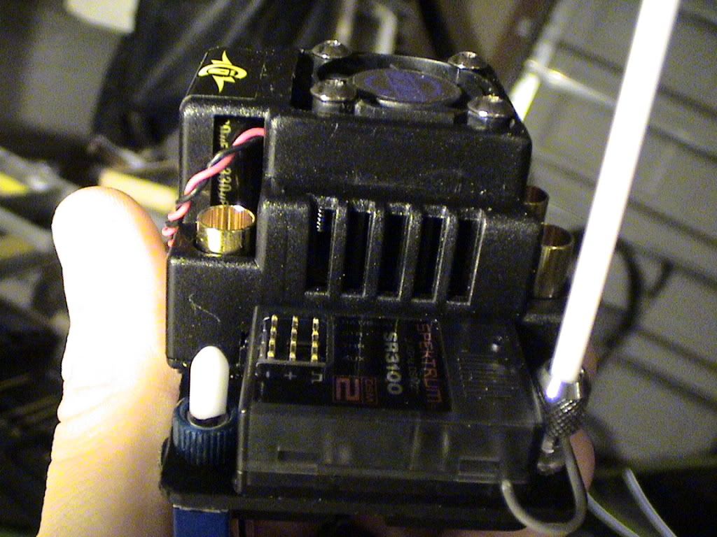

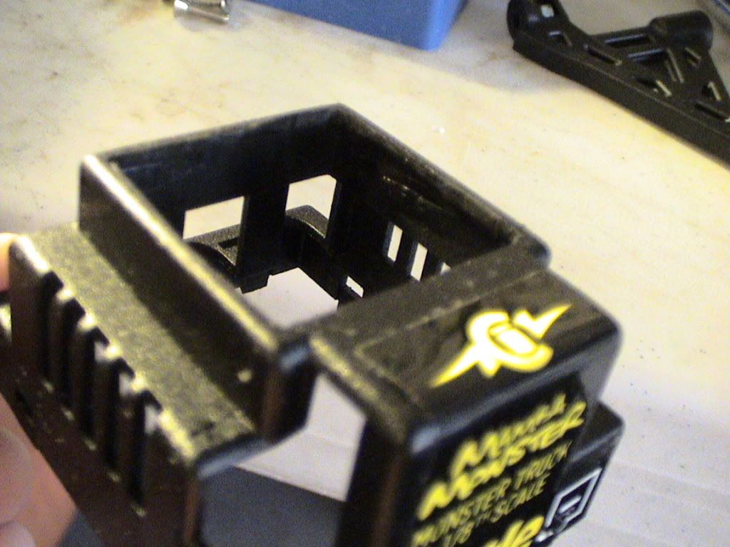

here is what i have done to my MMMs that seems to be working. at least so far they have performed flawlessly when i have done this. i take out the fan and put in my own that runs off the battery reciever terminal. i also take out the switch and put in a toggle switch. both tricks i learned on this forum. i have had 2 MMMs that had failed switches. not anymore.
take off ESC top
MMM mod1
remove fan
MMM mod2
cut out top of ESC casing
MMM mod3
MMM mod4
radio shack toggle switch
toggle2
finished product. a working MMM.....knock on wood.

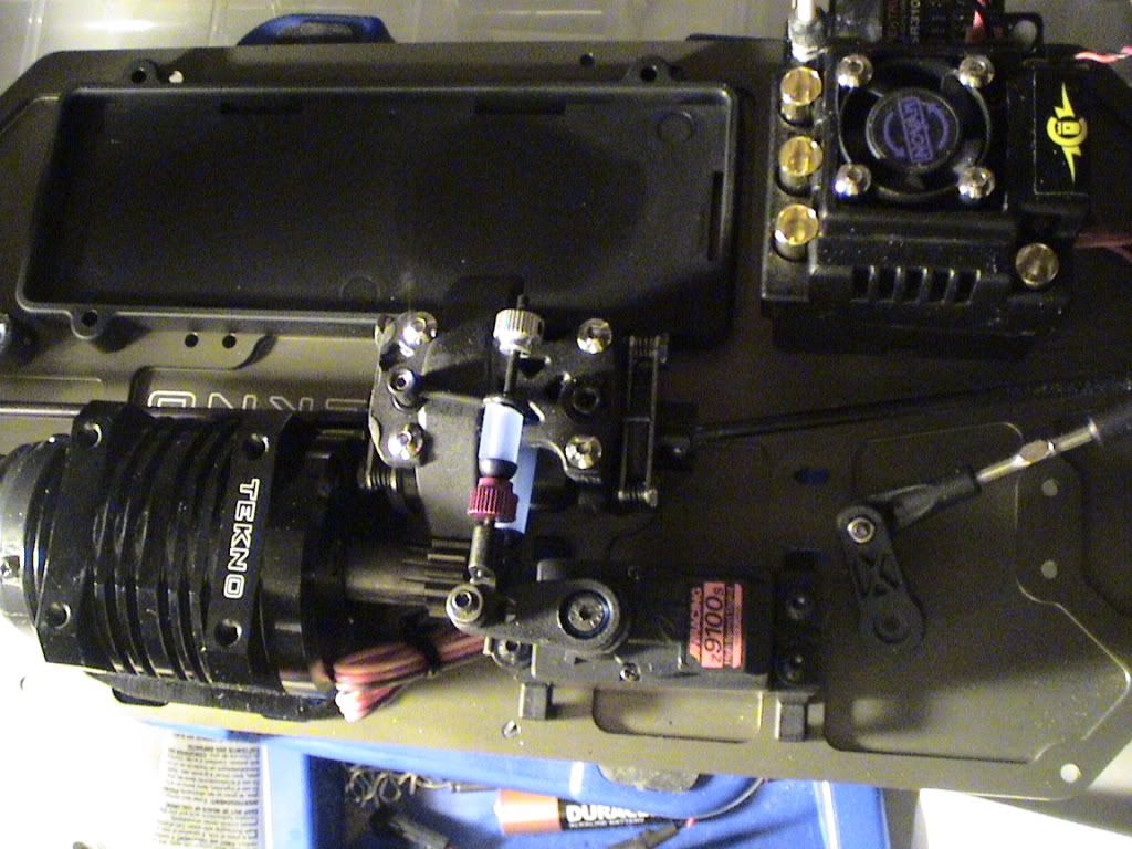

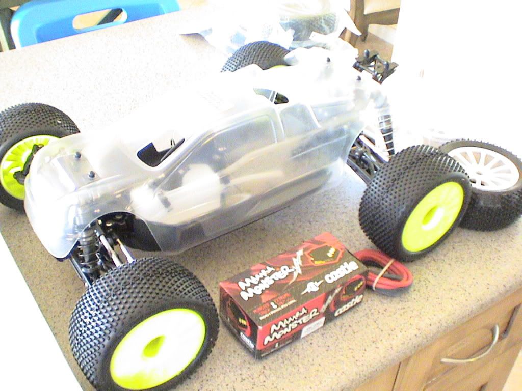

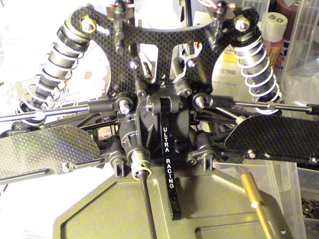

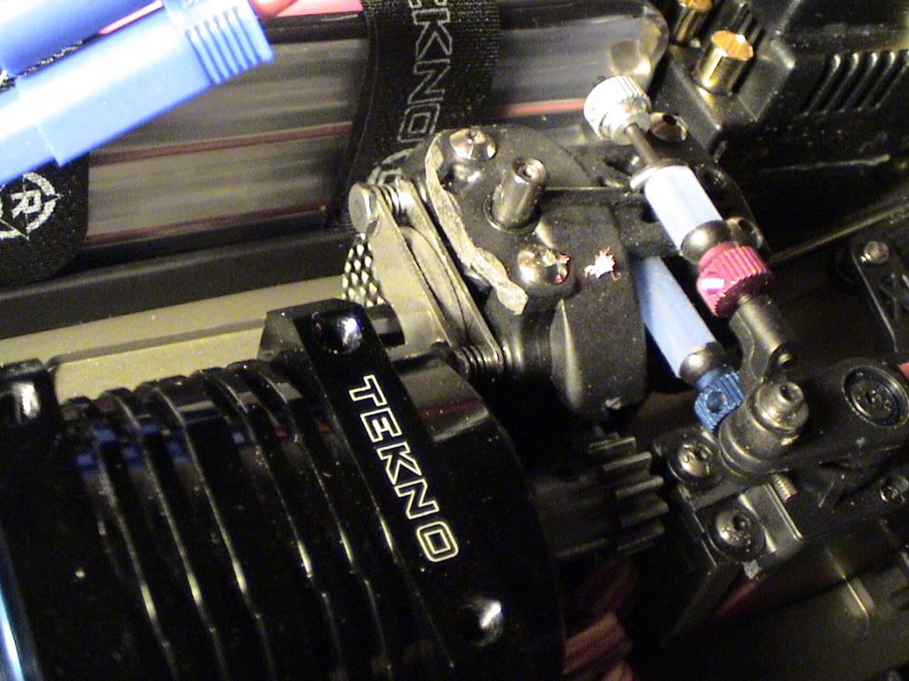

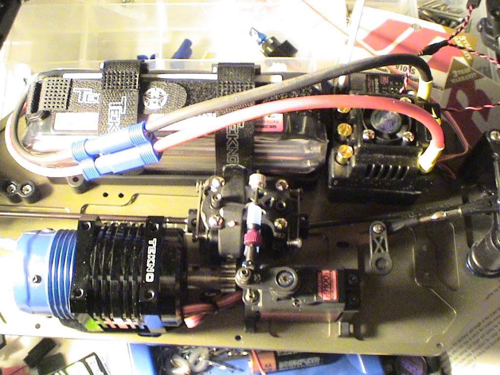

here are a couple of pics currently. i decide to throw the 1512 1.5d back in the buggy on 4s and i put the 1515 1.5d in this truggy on 5s. these new thunder power extreme V2 batteries kick ass. my buggy was doing about 60 last night with the 4s. anyway, hope to finish the thing this weekend.
i sent the body to florida for a guy to custom paint the true fire green flames. that is one thing i cant do for sure. i have found some pretty good lessons on youtube on how to paint the true flames but this is one build i dont have the patience to try and learn it right now.
radio deck mounted
losi 8t conversion1
center diff
conversion2
Jammin SCRT10 Neu 1512 1y

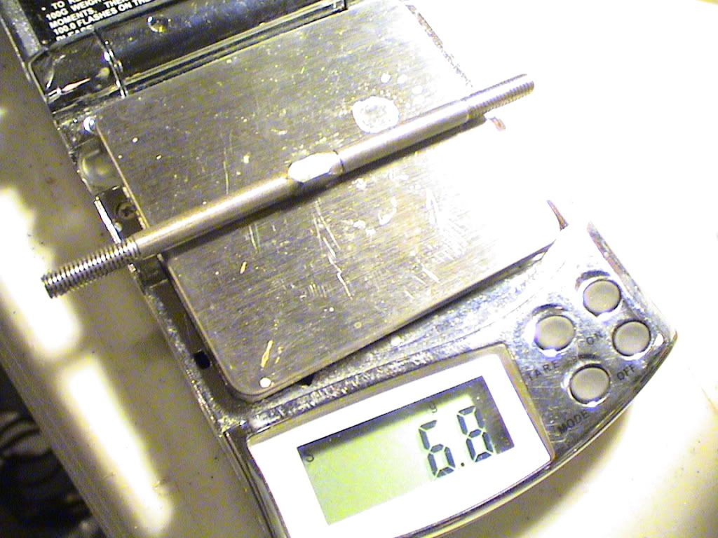

lunsford turnbuckle

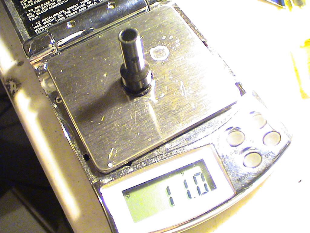

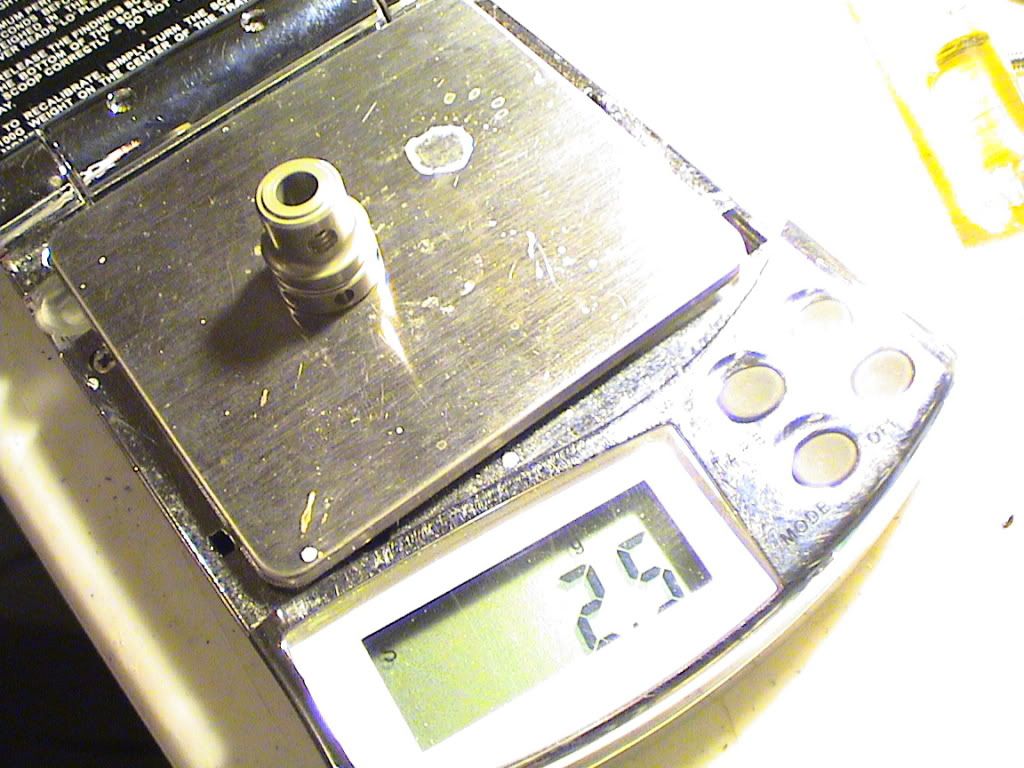

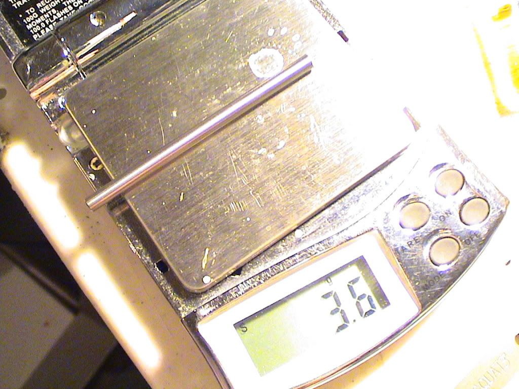

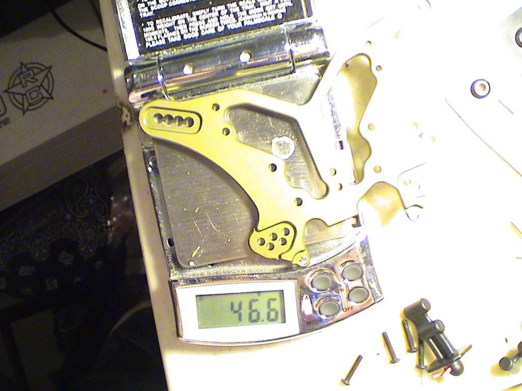

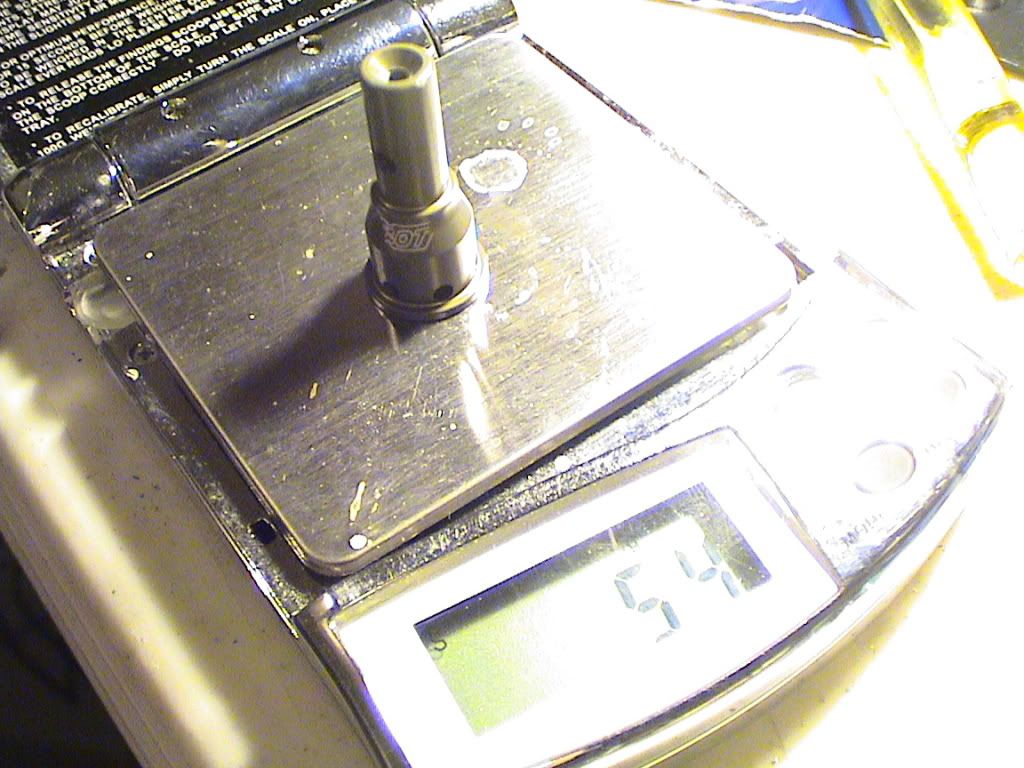

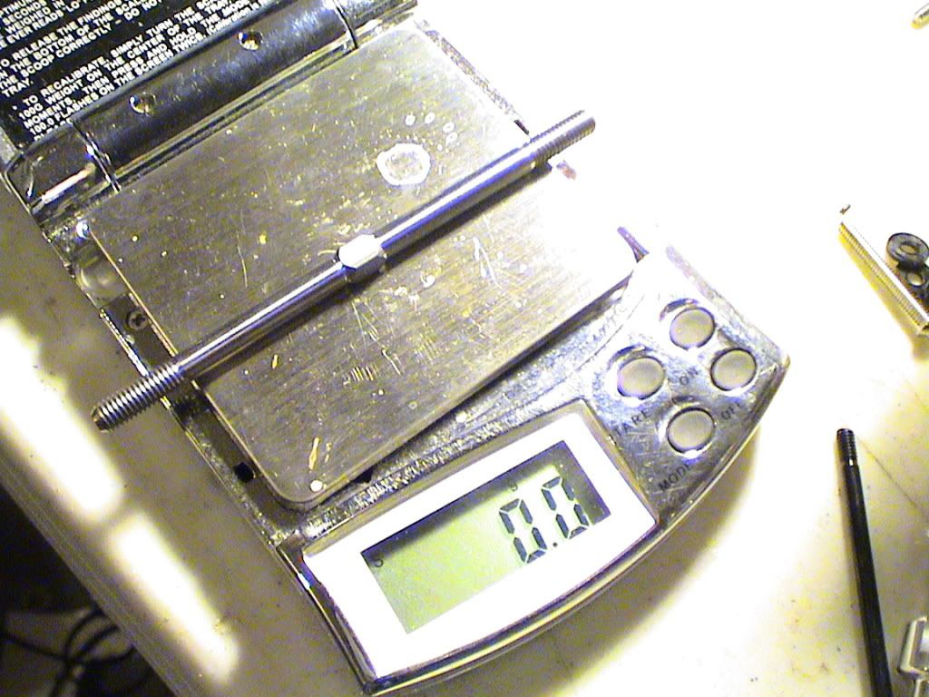

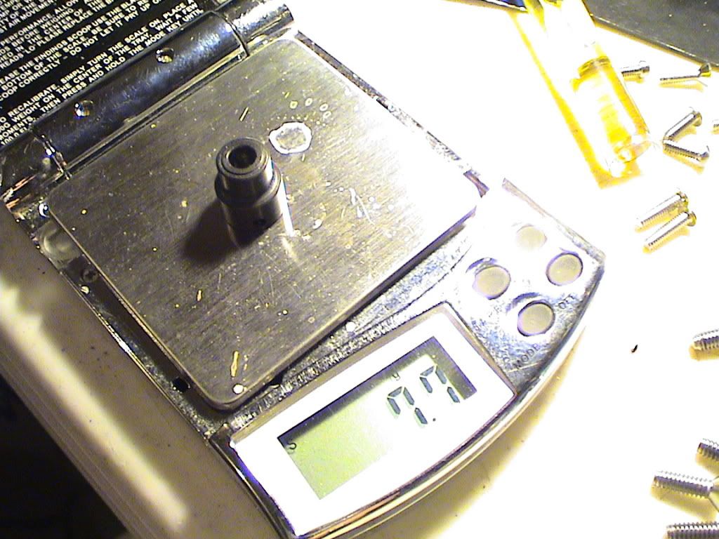

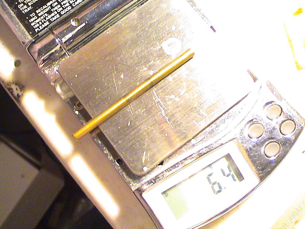

here's a few pics of stock and hop up parts weighed in grams. you'd be surprized how much weight you can save with carbon fiber, titanium, and aluminum.
titanium turnbuckle on scale "zeroed out"
lunsford turnbuckle2
stock turnbuckle is 6.8 grams heavier. about double the lunsford one
stock turnbuckle

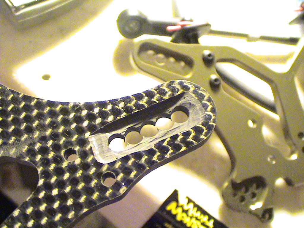

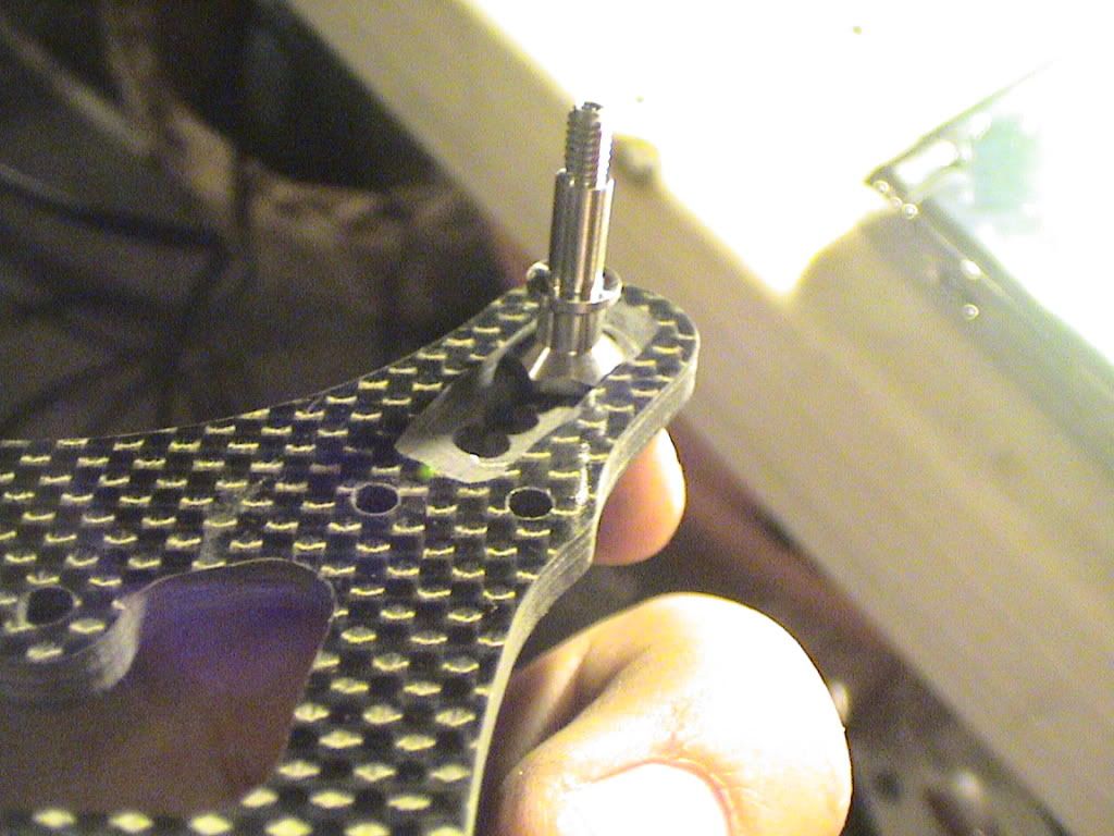

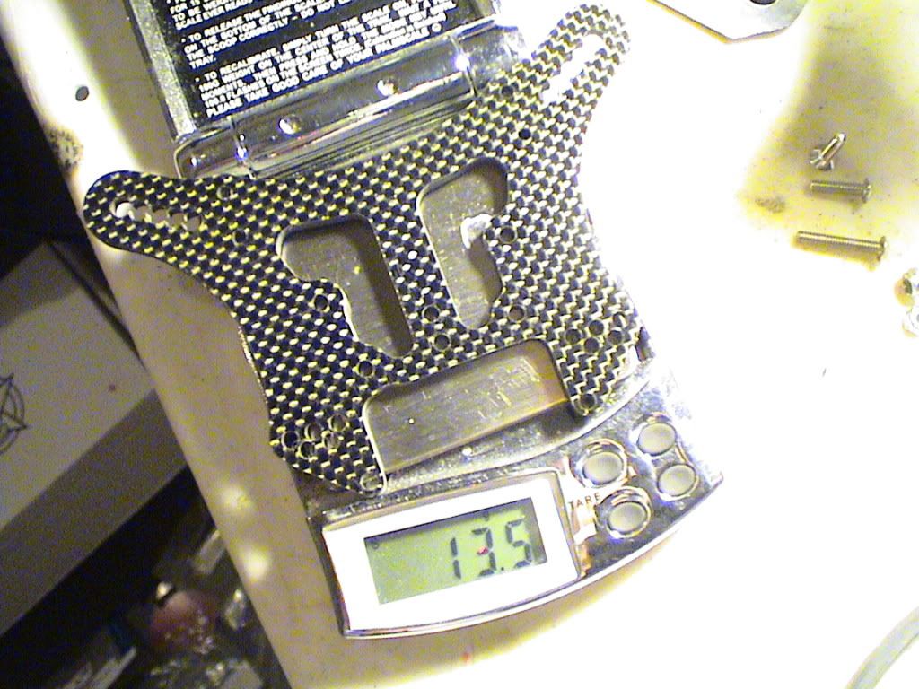

stock rear shocktower
xtreme carbon shocktower rear

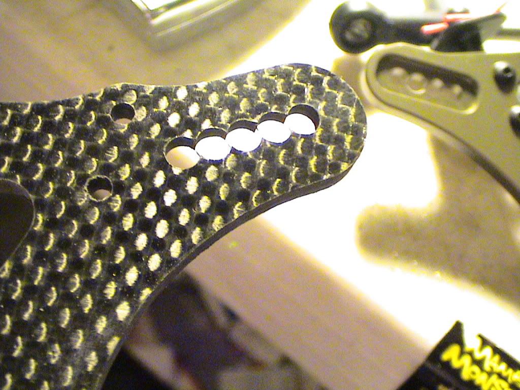

wow, i difference of over 30 grams. and this carbon fiber shocktower is way stronger than i thought it would be. it needed some modding though.
stock shocktower
carbon shocktower
mod shocktower2
mod'd carbon shocktower

stock hingepin
stock hingepin
titanium hingepin
lunsford hingepin
stock cvd coupler
stock cvd coupler
fioroni
fioroni cvd coupler
stock outdrive
fioroni outdrive

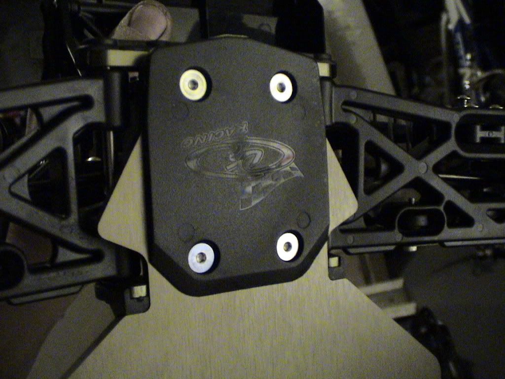

skid plate

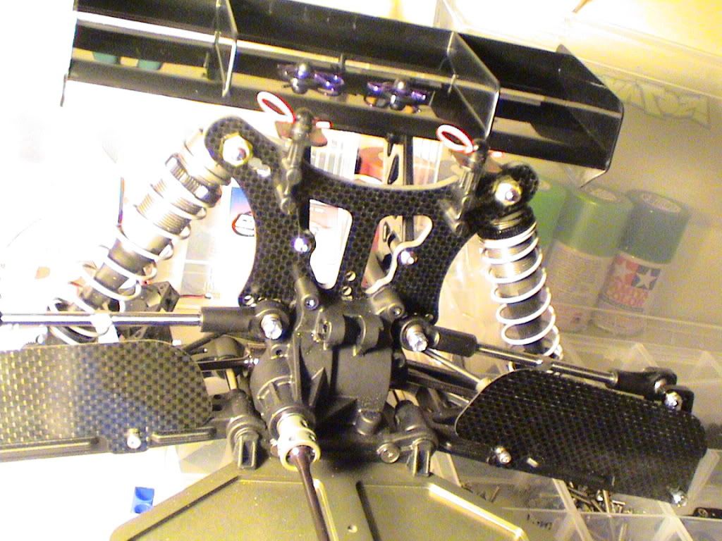

carbon rear
carbon rear2
