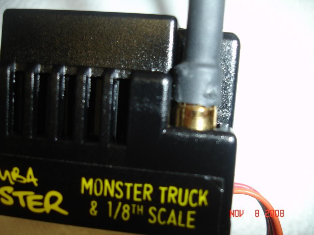

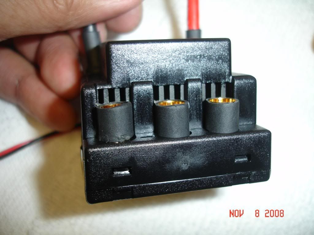

Well, I'm trying to install the MMM on my revo today. But before doing so, I installed some heat shrinks on the bullet connectors just to be safe. Everything went fine except when I got to the positive power wire. I can't slide the heat shrink on. It seems that the bullet is either too close or already touching the heat sink. The male connector was also hard to insert because it was rubbing against the case.
Here are some pics:
Motor to ESC bullet:
Positive power wire bullet:
No problem putting a heat shrink on the neagtive terminal:
I did not open the case to fix the problem. It seems that the bullet was not vertical when it was soldered to the board. I know that it will rub due to vibration and impact later on but we'll see how long it will last. The only modification I did was to lengthen the wire for the switch.

I am not questioning them. I'm just saying that the bullet was not true vertically when it was soldered to the board. The negative terminal is fine and has about 2mm of clearance. Since it is leaning towards the case, it is being push away from the case when I inserted the male connector. This could mean undue stress on the board to bullet connection.

That is exactly how I feel about the tight connections as well. Went through the exact same song and dance minus putting the shrink tubing on the connectors. Not too keen on the idea of mechanical stress on a solder joint, myself.

I too did the heat shrink thing today, but only to the battery terminals. I shrunk the bits halfway so that they slid all they way down the connector, because if you take a good look you'll see they're recessed quite a bit inside, and the space around it is extremely tight.

Have you just checked to see if indeed there is a short between the barrel and the heatsink? Very easy to do with a voltmeter, a battery, basic stuff that you should have laying around. Much easier to check than to speculate on a forum like this....

And for the second time, I'm not worried about a short . I'm going to say again that my concern is the fact that when the male connector is inserted into the ESC connector, it is pushing the connector away from the heat sink which puts undue load to the soldered point. Do you understand that? As you can see, there is no gap between the positive connector and heat sink while the negative connecto has about 2mm. I also checked the 2nd V3 I received and it was soldered better. There is at least a 2mm gap between the positive/negative terminals and heat sink.
