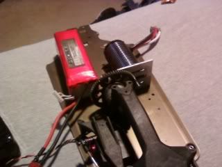

here is the current setup mocked up, a single 5s pack, opposite the motor- the esc was behind the motor and the rx

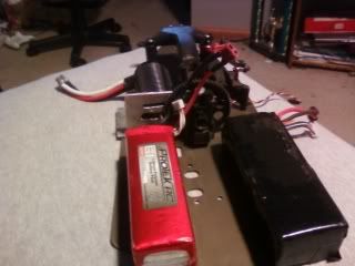

And here is what i was thinking

two in parrallel?
Thats over 1kg in weight... I was looking at 2 of these in parallel
http://www.hobbycity.com/hobbycity/s...C_Lipoly_Pack_
6200mah total, 144a Cont, and 216a burst
total of 120 dollars :D could get another 2 lipos on top if i wanted to

That would be perfect. The 3k Zippys are like 15c and may not hold to the MMM, but those will work just fine.

wow thats more amps then my current setup
4000mah 25-35c pack

That second picture could work if you found some creative spot to mount the steering servo.
In the second picture the packs are saddle'd in the rear of the truck, motor across from the servo... could probably mount the esc on top on the steering servo.
