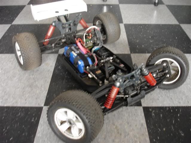

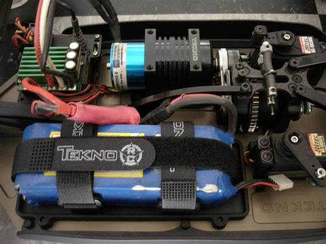

See my replies inserted below.
Originally Posted by patxeik View Post
hi all
Since i converted my revo with the tekno conversion i just think to convert all my nitros to bruslee. Now i have a mugen mbx5t coming up to me the next week and i need some information about the conversion hardware,.....
1- which motor use?
i already have a Tekno RC Edition Neu 1515/1Y/F Motor (5mm shaft, 110A, 2200kv) will be faster enought for the truggy with 4s lipo?
I guess that depends on what your application is. Are you racing? If so the 1515/1Y on 4S is plenty fast to run against the nitros. I've run that setup before in a Jammin CRT. Right now I have Medusa 2300 on 4S in the MBX5T.
2- i will use 4s 5000mah lipo, will fit on the battery tray.
The tray dimension is 150mm X 50mm. Longer batteries will fis with modification to the tray (cutting the rear lip)
3- which motor mount use for my neu 44 o 36 mm?
44mm for the finned can
4- how many brace i will keep from stock? i think just the rear one, and the others are made from plastic or nylon? will you made an aluminum upgrade for those parts? You keep the rear brace and the others are aluminum.
Anyone have more pics of the conversion, i wanna see how the motor mount move into the chassis to atack the spurgear The holes in the motor mounts are slotted to allow left/right adjustment the same way they are for nitro engines.

thanks guys for the replys, riceman your pics really help to decide i will get this kit.
Im not going to race the truggy against nitro truggys cause there arent many races of this cars in my country, maybe i will race against buggys hehehe but im doing that just to have fun, not to race, i hope my neu 2200 have enought speed.
Riceman are you using the kyosho plastic spurgear? or its not necesary since this kit use an elektric-clutch?
