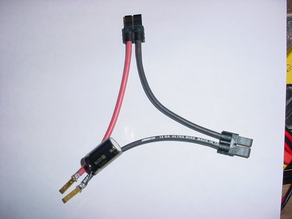

I'm always looking for new ways to improve my E Revo.

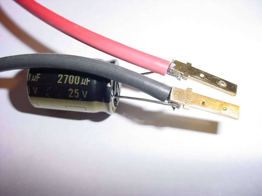

The Capacitor used is a Low ESR 2700uf 25v version.
I decided to give the this a shot and see if it helps. (It surely can't hurt)
The heat shrink used is single wall with hot melt glue inside. I like the way it grips the connector AND the capacitor. It should be sturdy enough to survive.
It will mostly be used on 4S, but I have ran this cap on 6S with great results.
