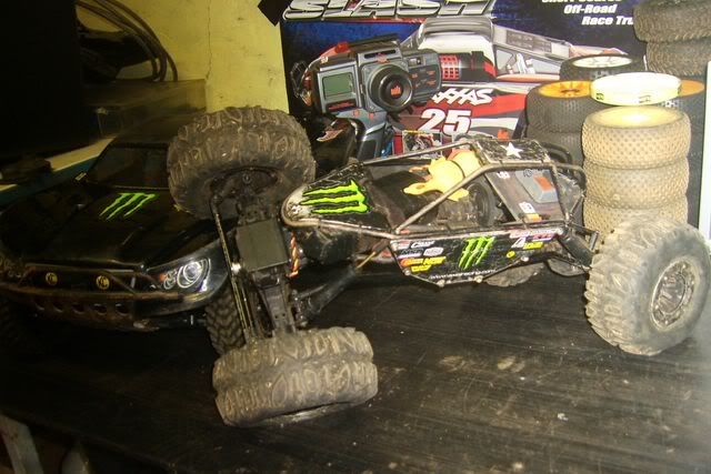

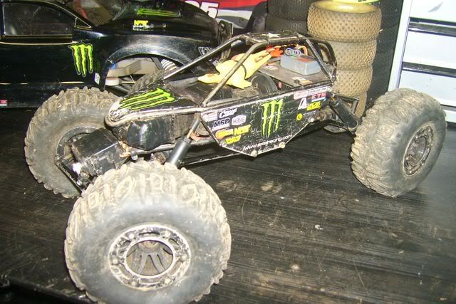

Im new here and figure I would share some pics of my junk. Its just a AX-10 with a Edge Chassis and the usual mods.
Sidewinder ESC
Integy 35t motor
Soektrum Radio
2 cell 6000 lipo
Hitec 645mg servo (need something bigger)
TCS 4 link plates
TCS Edge Chassis with custom aluminum panels
TCS Delrin skid
TCS Bent lower links
Droop Shock setup
Stampede Shafts
Panther Tires
Next on the list for it is a R2D Tranny and a better steering servo.

Looks used :) I'd look at the axle links as front axle is clocked pretty far...
I'd look at a much smaller lipo and bec along with the servo - that thing is a beast!

What good will clocking the front axle down do? Its all still stock geometry. Same length links.

You get better steering if the front axle is tilted back a smidge, or at least even with the ground.

Better steering as in more throw or what? Ill have to look into that.

Same throw mostly, but it would actually be steering properly(side to side). Which would equal better steering.
And your running a 35T and want more wheel speed?
