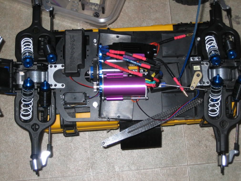

I want to upgrade my truck to an "overbuilt" brushless system, because my truck will be very heavy. I'm looking for something like a high turned xl motor, and a better brushless controller (rated for more amps).
I'm also looking for a lipo battery system (this is where the truck gets heavy). I run a pretty large BPP chassis, so I think I fit in quite a bit of lipo. Call me crazy, but I want 22.2 volt (18.5 nimh cell equivelent), 20,000 mah power system. I do indeed have the money to dish this out, so be creative:p .
I don't want to pull alot of amps, so maybe an 11xl motor and a 12020 esc?
If I find a system that works out for me, I will be having a Feigao 8xl (run very little), a 9920 (new, never even programmed), 2 pairs of fusion 8 cell straight line gp3300batteries (1 pair is a 1.75 volt spend $180 on it, and the other pair was 120). PM me if interested. Or give me an estimate of how much I can get out of all this on ebay.
Here is my truck so you can get an idea of its weight, and configuration (esc hasn't been mounted):

If you want all this power and such. I would say a 3695 controller. Run a 12 xl wander on 8s lipo. Have great power speed and run time.

You painted your topedo chassis black? looks killer! Any certain paint?
N. Rustler conversion

no special paint, but thank you! Coolhand, ygpm
