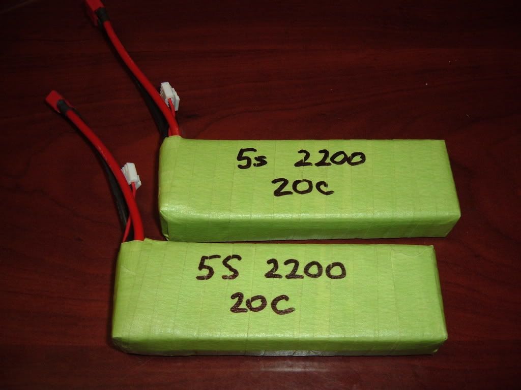

I have a feigao 20xl (835kv) and a pair of 2200mah 20c 5s lipos. So figuring 10s lipo thru the motor should get it spinning around 30k rpm. Gear it about 20/40 and leave the 2 speed intact in the revo tranny. Forward only so no reverse servo. Keep the mech brakes too. Thinking of using the great planes hv esc that recently came out with a pixstix adapter.

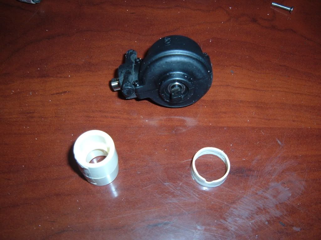

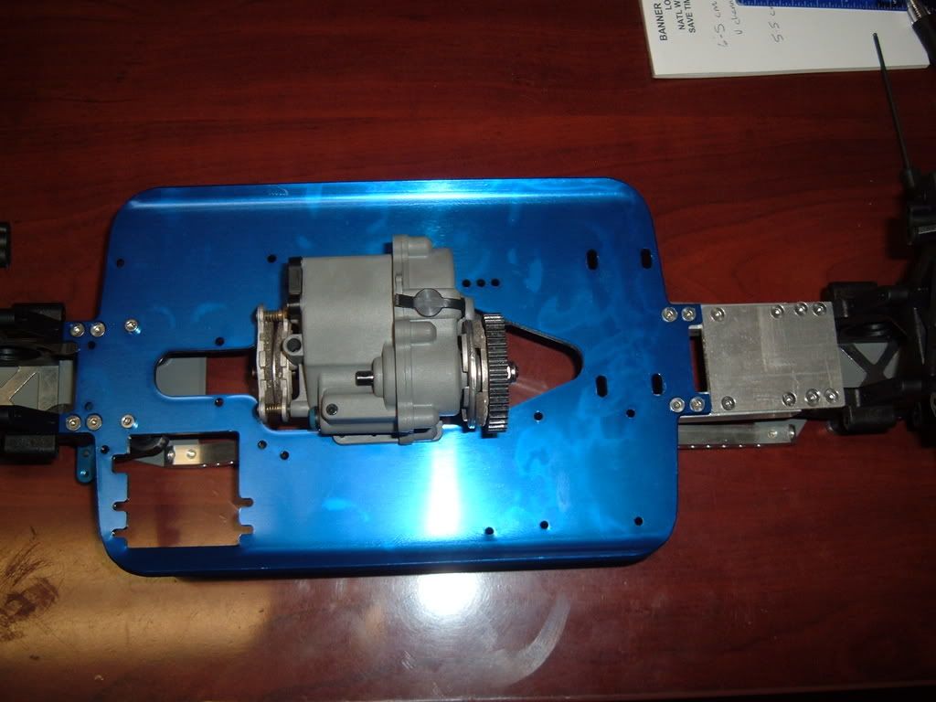

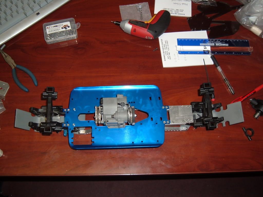

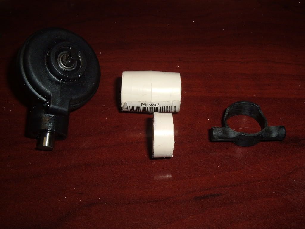

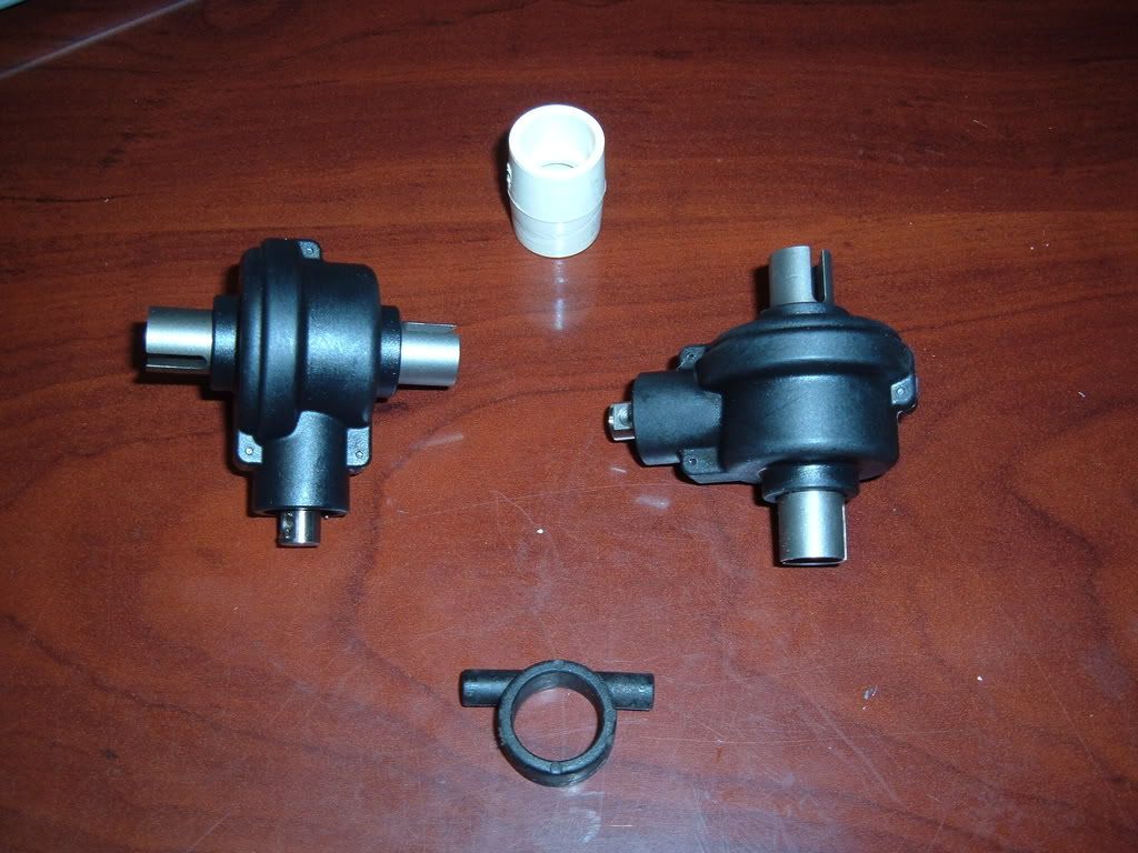

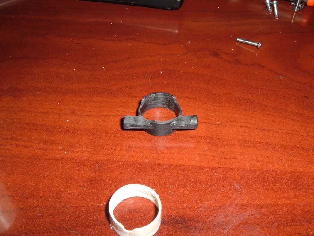

Update time! -
01.05.2008, 08:19 PM
01.05.2008, 08:25 PM
01.05.2008, 10:43 PM
There is no help for me... I'm addicted to R/C
Posts: 291

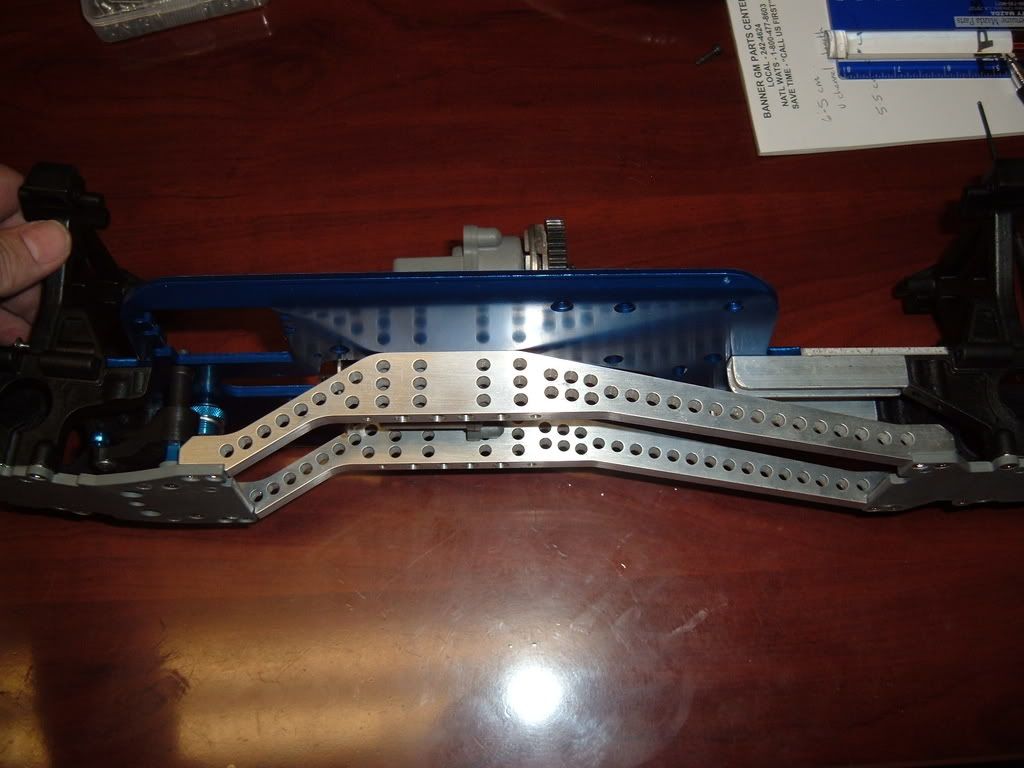

01.05.2008, 11:11 PM
hahaha sweet man! and I love the extended chassis braces!
01.05.2008, 11:37 PM
Its all your fault. Now that my maxx has beefy diffs I can finish it up! I have about 4 other maxx trucks that may get the diff mod too!
Posts: 2,085
01.05.2008, 11:56 PM
Keep up the good work Linc!
I may be following in your footsteps on this one really soon.
What gear ratio are those diffs? If I recall correctly, they use the 43 tooth spur and are 1/8 size.
Will the spiral 43 tooth ring and 10 tooth pinion fit these?
Looks like a 8mm pinion shaft with 6mm output shafts.
01.06.2008, 12:02 AM
Thanks Sike!
The diffs have 43/13 gears, and I see no reason why the hb truggy gears would not work. I have a spare hb diff somewhere I will try it out in the case (factory al cases cost 10 bucks each!).
The 6mm outputs are mike's output adapters. I will run the new emaxx driveshafts you are sending me! pinion is 8mm and I will run a set of mike's adapters to hook up revo sliders as center driveshafts.
The chassis will need to be clearanced so that the rear driveshaft will fit. I may be out of luck with the revo motor mount. I may have to make a different lower mount that will clear the driveshaft. I will take a pic of my proposed setup and we see what it looks like.
