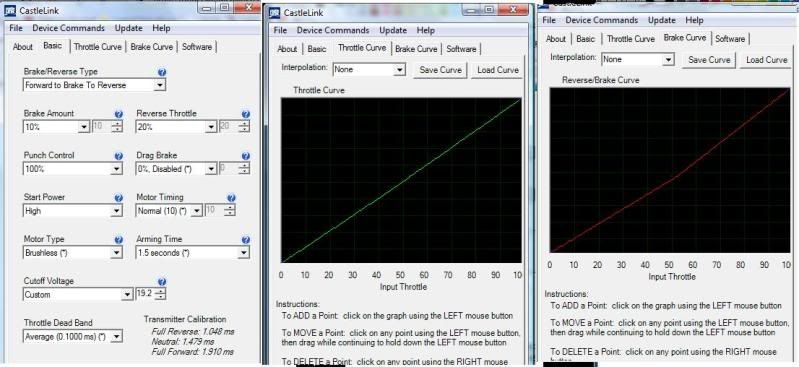

If i go foward im getting about 6-7 mph
if i go reverse, this truck is like a bat out of hell :D
What wonders me is why? Do i already have a defective ESC?
Here is my set up

Reverse the Tx throttle channnel, then reprogram it to the MMM. This happened to me the first time I used my MMM.
