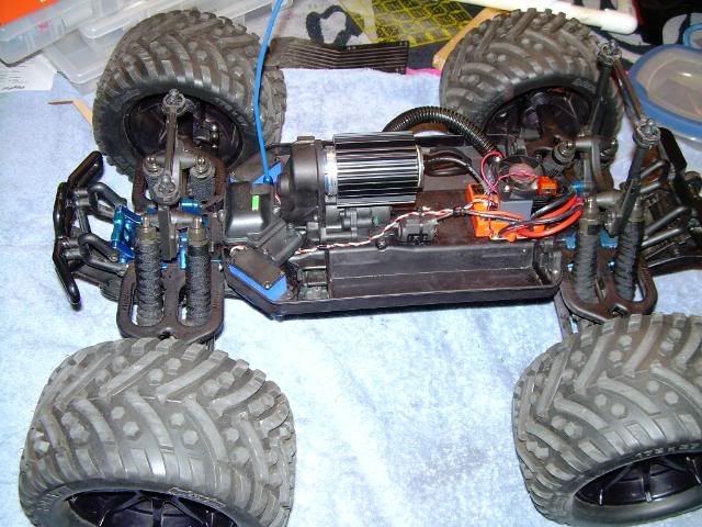

heres a 3905 with a novak setup. if you use the traxxas part above^^ you could mount your combo in the same way, motor where motor is and esc where esc is.
