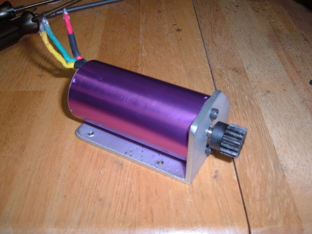

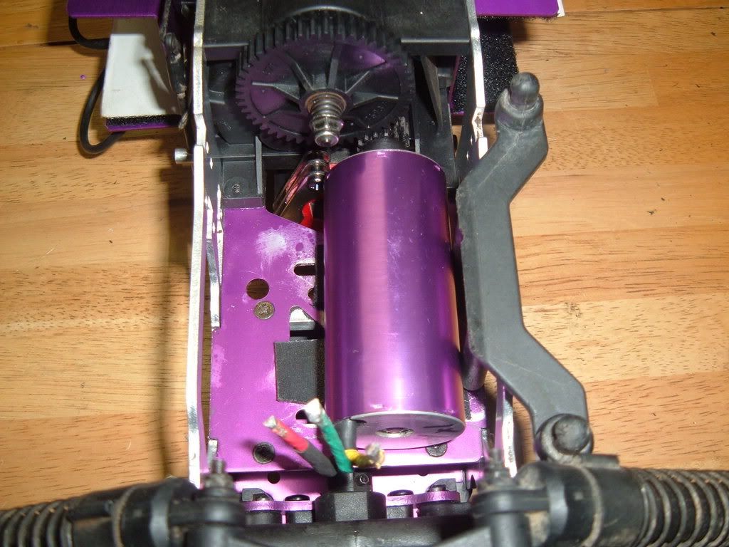

It may be a bit bulky to do what you want with it. You could "window" the tvp like the flux does and stick the motor out a bit. I made a simple L bracket mount that would allow a 36mm motor to fit almost on the stock nitro mount area and was adjustable thru 14-20t pinion with a 47t spur. If you go to the 44t flux spur you will have more adjustability than I did.

That is slick, that is the type of thing I would like to move too. I am running the 44 tooth spur to keep the gearing straight in my head and keep everything cool. Thanks for your input as always!

I have an XLT motor sitting around from Fine Design (Before I knew better). Is that about the same size as the motor you have there? And how much for one of your mounts? Thanks

It is the same size, 36mm in diameter. I will pm you the price!
