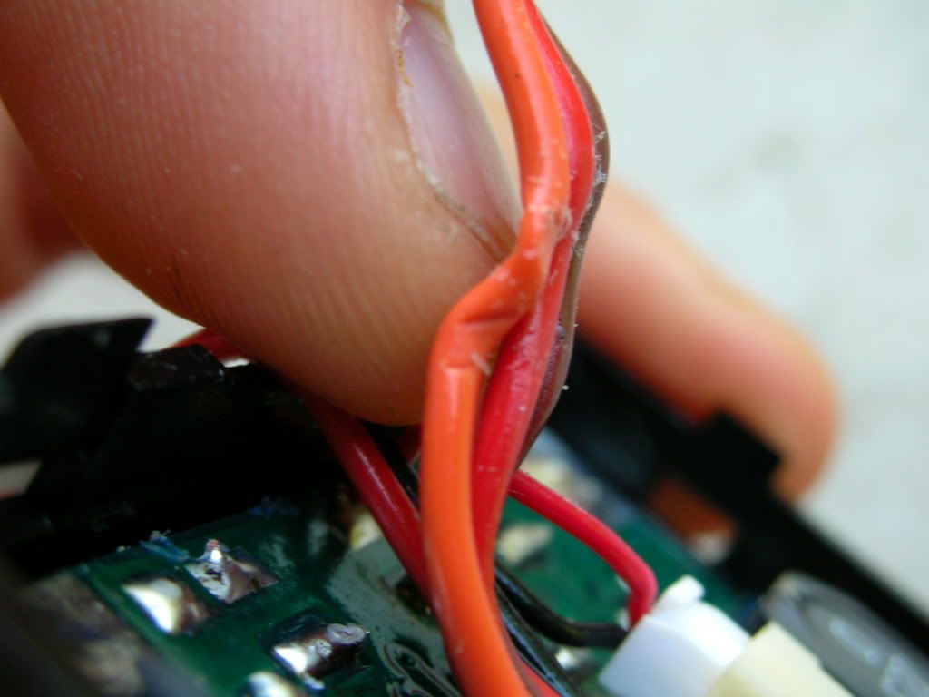

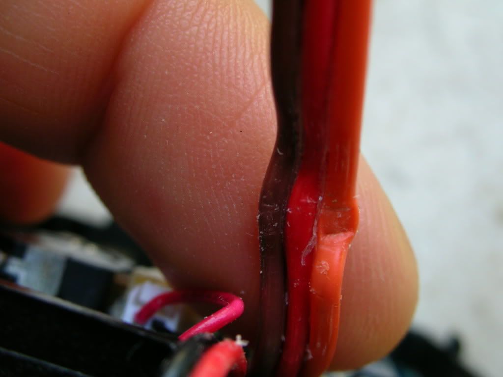

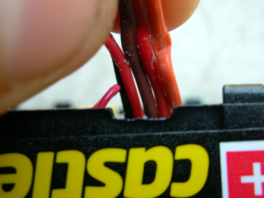

There is no need of an engineer to see that the small hole in the body esc is too small for 5 cables. In fact when they have assembled my esc the orange cable has been barely cut by the plastic case.
07.04.2009, 05:21 AM
ya know, mines like that too. I never liked how the 5 wires fit in that little slot. I never took the time to complain about it though.

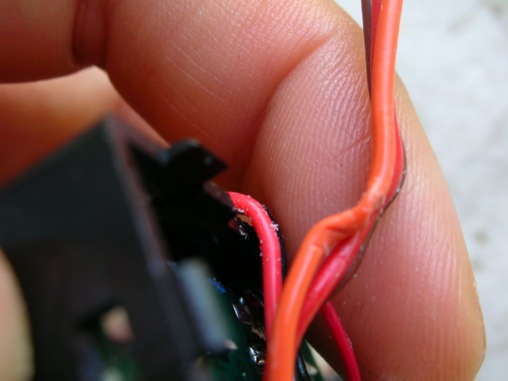

moreover the black heatsink is not well aligned and touch one female motor phase plug.
Fan red cable is ruined by wrong assembly as the orange one.
Maybe, a lot of failure are a consequence of the poor attention in the assembly

I use a razor knife and open the slot up so all of the wires can exit in a uniform manner. If castle give me issues about that I will take a pic of all of the castle products I have and send them that.

Well, we actually designed that hole to put a little pressure on the wires so it would strain relief the point on the circuit board where the wires solder on.
I haven't seen any failures due to the pinch point personally (so the repair techs haven't seen a lot of failures due to that... they get pretty bitchy about things which cause a lot of returns...) -- but we are doing a revision on the MMM case soon, so I'll have my mechanical guy take a look at it. Maybe we can put a longer strain relief internal to the case to take some of the pressure of the wires.
Patrick
Patrick del Castillo
President, Principle Engineer
07.07.2009, 01:30 AM
On my original V1, I enlarged the hole, but then put heatshrink over the wires so that the case still clamped down on the wires, but the shrink protected them. Seemed to work ok until it went up in flames, lol (unrelated issue).
