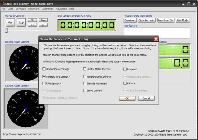

Yes, under Hardware I have checked, "choose parameters to log in the recorder"... but all it has is motor current, motor voltage.... which is for their expander, or Seagull, whatever it's called.
Check the pic...

Yours looks different than mine, but I'm using the latest beta. Try checking the "electric motor current" and "electric motor voltage" boxes. What exact and version controller are you using. For instance, I have the e-logger v3.

I can't remember which one, either Micropower logger V1, or V2... I bought it in spring of 2007. I'm it's thinking a V2. Even so, they say it should work with the 6.93 software.
I am looking at the recorder firmware, it reads 5.41 for the recorder. Is this what you have?
