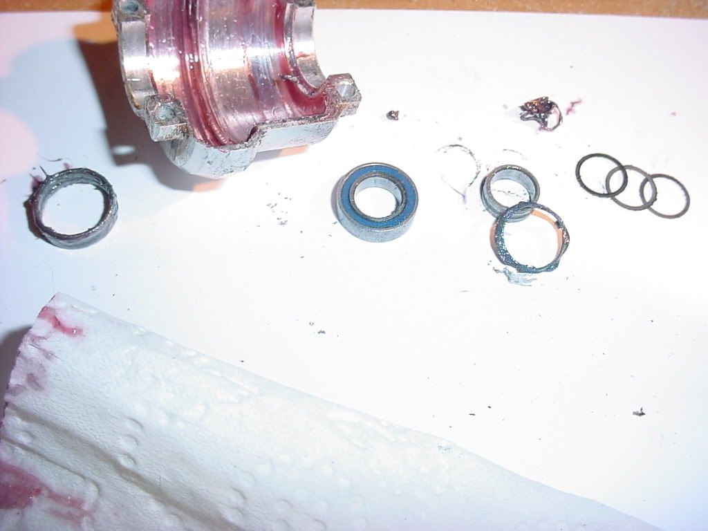

08.01.2009, 11:53 AM
Sikeston38m had bearing issues with his DDD outrunner powered revo using spiral cut gears, Have a look at his threads and there is a bunch of info there.
Yep, I could blow the rear diff in a single run.
I was using the Hotbodies 1/8 diffs in the RCM Revo diffs cases. Was even using the aluminum 1/8th diff cup to eliminate flex at that point.
The setup was shoving a ton of abuse at the rear diff. The weak point was the pinion bearings. I even upgraded to the ceramic bearings. Didn't make a difference.
The spiral cut gears load the pinion ball bearings as if they are thrust bearings. It would punch the center race through the bearing every time.
Little balls everywhere. LOL
The 13/43 straight cut gears proved to be the tougher setup since they load the ball bearings the way they are meant to be loaded.

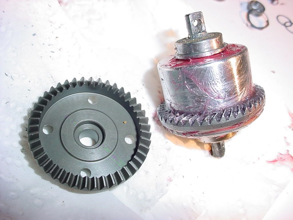

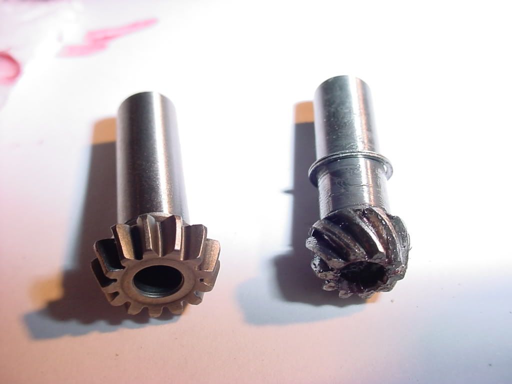

sikeston34m
sikeston34m's Avatar
Posts: 2,085
08.01.2009, 12:10 PM
Here's a couple of pictures
The spiral cut gears try to either pull the pinion into the cup, or shove it out of the diff. See the comparison? The only thing stopping it from doing this is the bearings.
sikeston34m
Posts: 2,085
08.01.2009, 12:13 PM
Here's a picture of the two ring gears side by side.
Snipin_Willy
Snipin_Willy's Avatar
Posts: 406
08.01.2009, 12:44 PM
Interesting. I wonder if this was part of the intent when they started making them. Hard to imagine an engineer missing this sorta thing then a free body diagram should be the first thing the look at.
