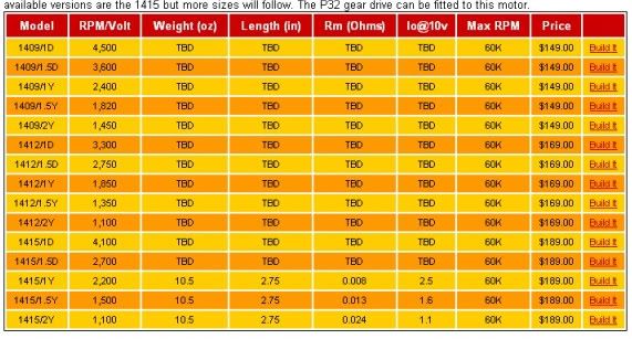

Look at this chart, it shows that the 1412 motors have a lower kv per wind than the 1415 motors. Ex: 1412 1D: 3300kv, 1415 1D: 4100kv. I thought that the longer the rotor, the lower the kv per wind. Sorry if this should be in the CC section, I wasn't sure since there isn't a neu section.
