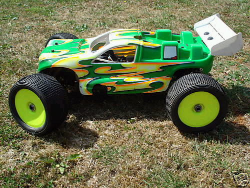

Oh, one question slightly off topic (sorry, but it is to help me do my brushless calculations, honest!) - what are the stock tyres? The truck is still in the post, but I have the picture below - are they stock? If so, what diameter are they?
EDIT - I just realised, as you have the buggy not the truggy you are probably not familiar with the truggy wheel sizes! Sorry.
