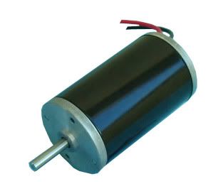

by the way, this is the motor:
It is 66mm in diameter, and 110mm long, with an 8mm shaft(fits mike's mod 1.5 pinions), and weighs 46oz and is 443kv. It is the same size as a neu 22xx series motor, but is brushed. It will be plenty of motor for a truck that size.
the speed controller is a robot controller, that has fwd and reverse, and can handle up to 6s lipo.
and ben, we do have 2 un-matched 3s lipos. while that would be bad to run, it would be ok to run a 1 minute test to see if it is worth me investing in some 6s turnigy lipos

I'd still keep it gas! He could run all day as long as the receiver pack held out, hell he could use a bec/voltage regultor and use his 2s packs for the receiver packs and he could def run all day long instead of 20 minutes

Then again, you have a motor/ESC for it already. Don't know how you're gonna set it up so the mechanical brakes don't activate when you go into reverse (unless you disable reverse, but then you don't have reverse). And batteries are gonna be a challenge to find a setup that will give decent runtime without spending a fortune.
