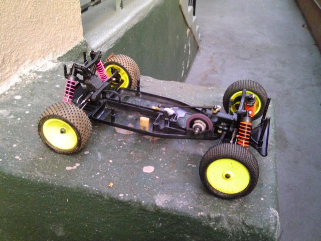

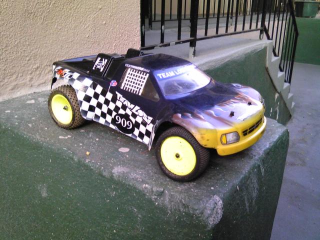

hey every i just picked up a Sidewinder ESC & CMS5700 combo for 60 bucks and a 49 min drive im putting in my xx4 i was wondering what would be a good size lipo batt.
i plan on racing this truck at my local track (oc/rc).

11.16.2009, 07:42 PM
Good charger, cheap alternative to things like the BC6 and 606i.
With the sidewinder and cms5700kv motor, I would keep it on 2s lipo for best results- probably something like a ~3000-4000mah 25-30c for best runtimes and cool temps. Basing that on the xx4 being like a belt driven 4x4 slash, sort of..

11.16.2009, 09:16 PM
would this fit int my car??
http://www.hobbycity.com/hobbycity/s...0mAh_2S1P_30C_
11.17.2009, 03:28 PM
No idea- time to break out your tape measure!
You will want/need to add a little to the lipo measurements as they arent 100% accurate- you dont want to have an uber tight fit, so allow for about 2-5mm.
