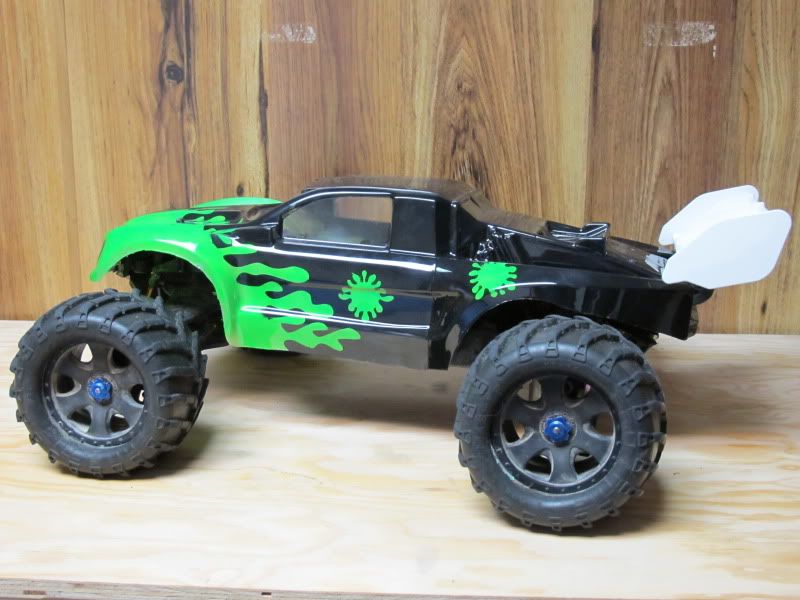

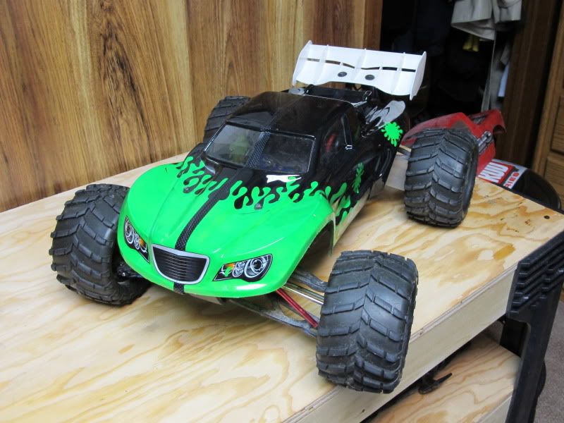

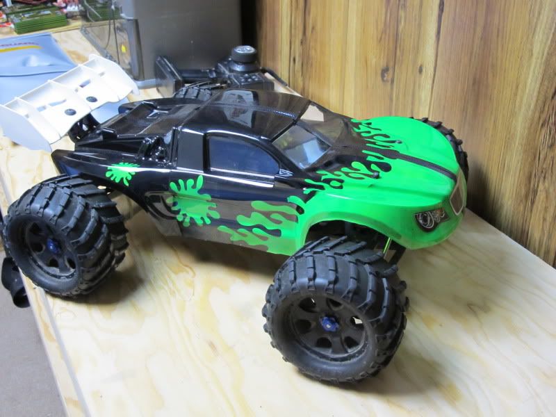

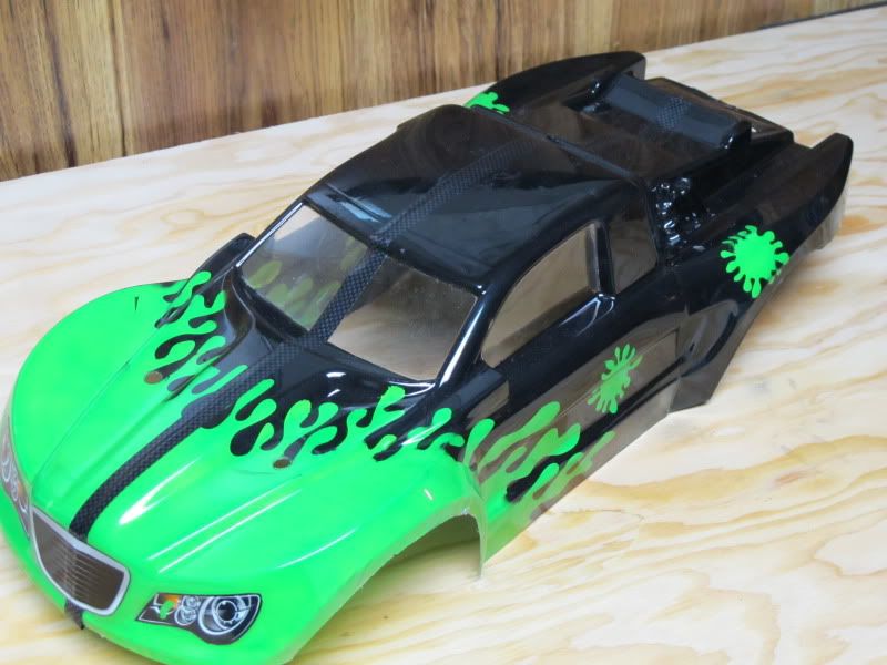

12.16.2009, 04:57 PM
Yes it can fit, with alterations.
I took about two inches off the width by marking it with a ~2 inch wide piece of painters tape. Then scored along both sides of it with a sharp hobby knife. Painted the body and used gorilla tape on the inside to hold it together (note you only get one chance to line up body right unless you want to mess up the paint). a strip of carbon fiber body sticker hides the seam.
Note pictures make green look MUCH lighter than it is
Body was a Proline desert rat for the slash
Note: I know my tires are backwards lol
Also no offset tires rub slightly without raising body or trimming more, but 1/2 offset tires work perfectly
