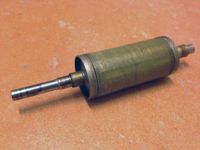

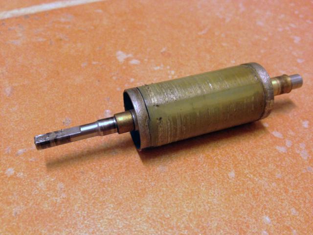

Was running my savage recently, and all of a sudden out of nowhere it as if slams the brakes putting it to a front flip and cartwheel. Upon closer inspection, the center diff is not moving. Came back home dismantled the truck and seems the 1717 motor is stuck, i.e. the rotor does not move or rotate. Dismantling the motor, and with some wiggling force managed to get the rotor out.
Seems to me the can is good but the rotor has somehow disintegrated or the fiberglass (dunno if it is fiber glass or other material) just tore and expanded a bit thus causing it to get stuck and come to a sudden halt.
Any explanation of what happened here ?! Note, temps were ok and the rotor is still well magnetized. Was running on 6S with a XL2.
Would I be able to find a new rotor? and if yes where?
Will the XO-1 rotor fit? and is there a repair kit yet for the XO-1 motor?
Here are the pics:
Rear view
Front View
The Rotor where is seems it exploded or whatever, shouldn't be like this, all the rotor should like the next pic
Other side of the rotor
Some pics of the inside of the can.
More pics of the rotor, f you look closely where the tear is you can see the fiber casing swelling a bit due to the tear

OUCH! how are your bearing? Could they have caused this?
08.10.2013, 01:43 PM
The rotors are kevlar wrapped. The rotor broke and the kevlar didn't hold it.
The can is likely good, but there are no repair kits available.
Basically it is a lost cause.
And no Kcaz25, bad bearings don't break rotors, it's the opposite actually. They gotta be spinning real good for the centrifugal force to split them.

Kcaz25, actually just last month changed my bearings.
Although I do agree with _paralyzed_, though if the bearings are bad the kevlar could be rubbing to the internals of the can and get compromised.

I actually think a bearing could cause this.
Excess vibration from bad bearing or misalignment could cause the rotor to fail.
Or shock damage when you removed the rotor could have damaged it.
This could have been self inflicted with you changing the bearings.

My castle 1717 (from the castle sale a few yeears ago) let go about 2 weeks ago. One of the windings "broke" leaving me with a useless can but a rotor which should still be useable. I have already replaced the castle 1717 with a leopard 4092, so i do not intend to fix it anymore. You can find a new xo1 rotor on ebay. If you are interested in a used rotor for less than half the price of the new one shoot me a PM.

You are correct although I was very careful and did not have to remove the rotor out, just the front and end caps and replaced the bearings. Although you never know....
A RC Dude, don't think castle still have rotor for these motors anymore, and as brian015 pointed out the XO motor is different. A good price used rotor is my best bet (thanks to othello)

Thought to update, Got the rotor from othello, using my can I installed the rotor and the motor spinned nicely. The only concern I have is that when you hold it in your hand and raise the rpm you feel a slight vibration. My thinking during handling of the rotor some balance weights (i think these pads of epoxy went off). Need to find a way to balance it.
but I don't think its too much vibration.
