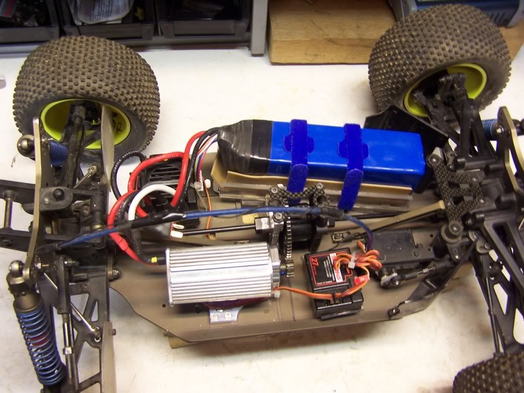

this is how i rum my crt now. its a revo mount.
dont laugh at my traxxas Tx/Rx, it works fine! LOL

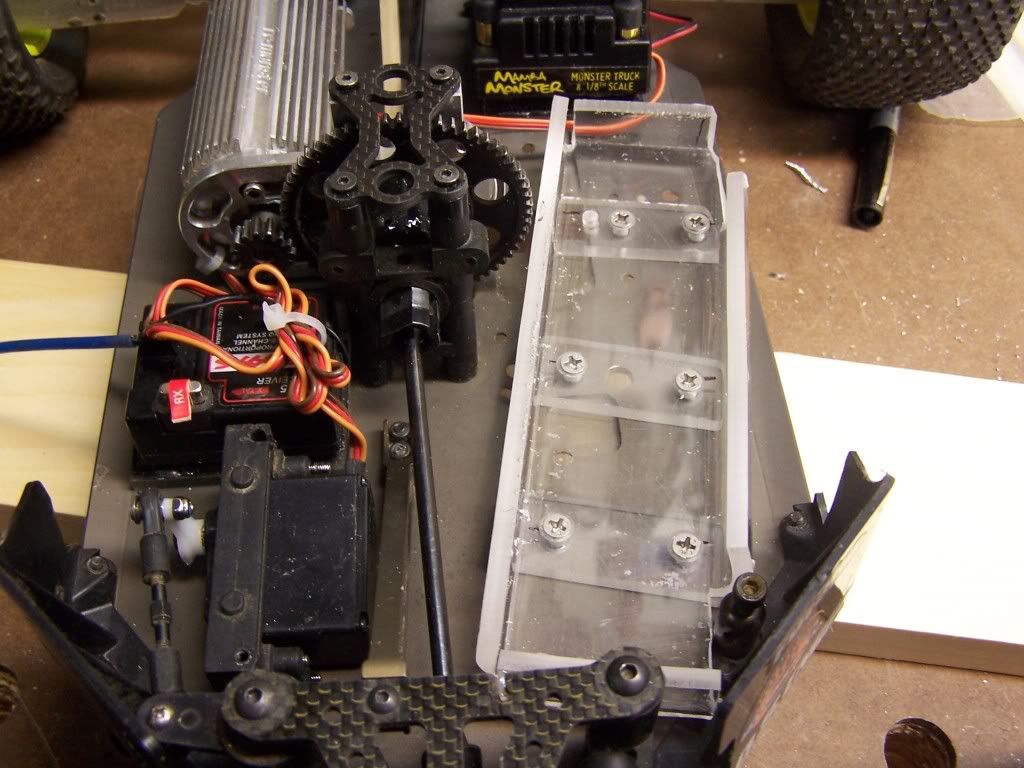

that would be a good choice, but if an eleven wont quite kit u will be fine with a 12t pinion also get a better battery tray there is no way that will protect ur battery, get a monster tray or something that battery is going to want to move more than u thing especially when u case jumps or cartwheel or land jumps hard.

I think my battery tray will work. heres a pic.
I think i will get a 11t and 12t pinion just to be safe.

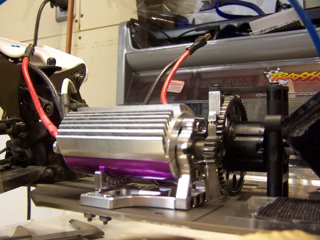

Notice how when i used the rcm crt motor mount how close the screws were to falling through the holes with a 14t pinion, thats the reason I went with a revo motor mount that i allready had. now im concerned that the screws wil be too close to the other end of the mount. LOL

The CRT mount will allow the 46t/11t gearing, but the CR mount is the better option when using the smaller spur(diff rides a lot lower). There was a batch of CRT mounts that was pretty limited on the pinion size when using the 62t spur - looks like you got one. It will work down to about a 9 or 10t with the 46t spur.:)

just an update. I paid about $100 for this stuff and with the 11t pinion it doesnt get close enough to mesh with the 46t spur. I am really dis a pointed, I just went from one extreme to another. I will have to grind out the slots to make the track longer but im not sure if this will work right. I have had this truck for about two monthes and I only ran one battery pack through it. If get a bigger pinion then it might be too much strain for my feigao and I dont have the money to buy a better motor. any ideas before I ruin this motor mount?
