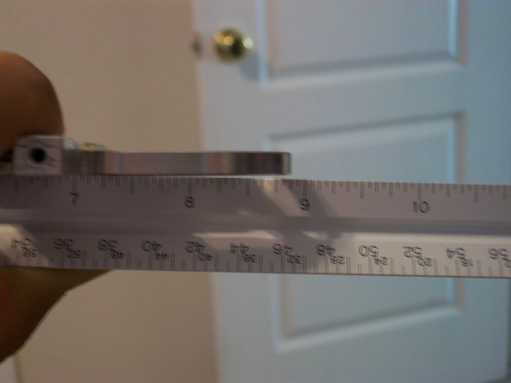

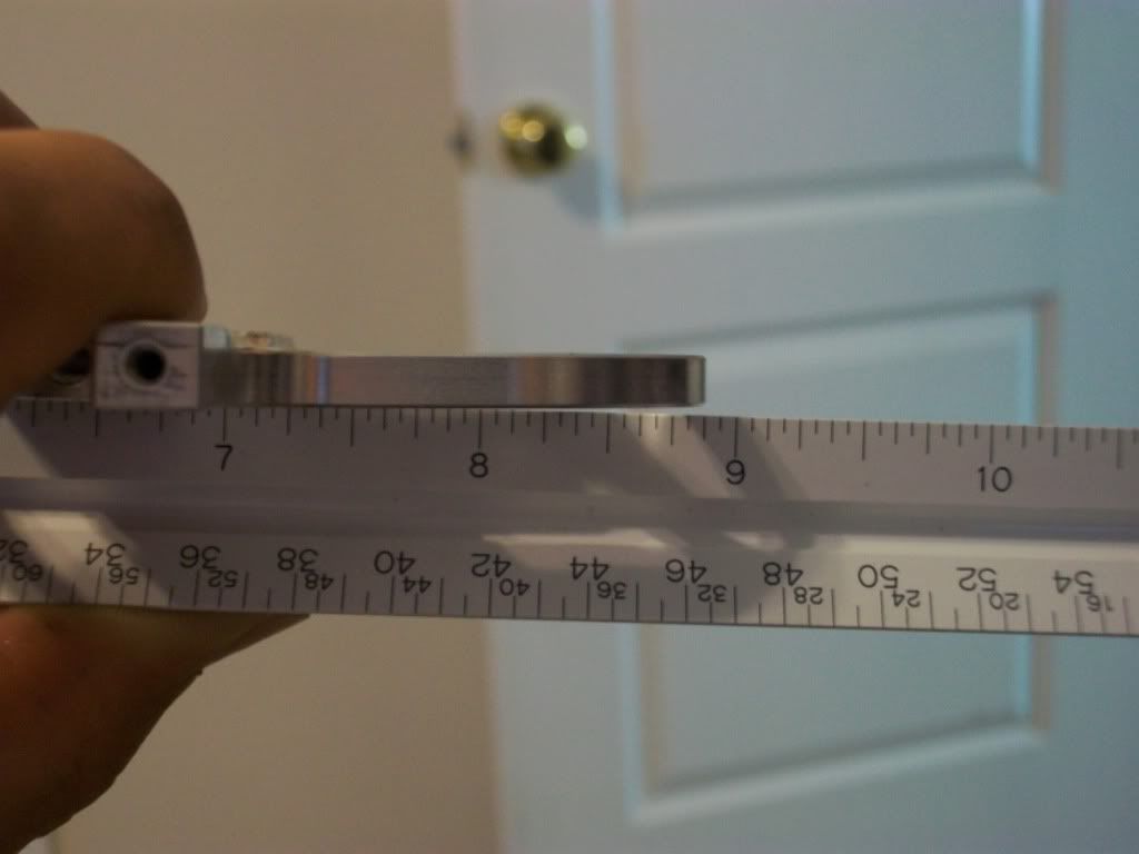

sent it in to Mike last week to get a replacement....tried straightening it but didn't have much luck and didn't want to mess it up more
Not sure if he's gotten it yet but I haven't gotten an email or anything
Don't know what caused it but it might of been lawndarting the truggy from like 8ftup and 25ft out
I've been going crazy not being able to drive it
