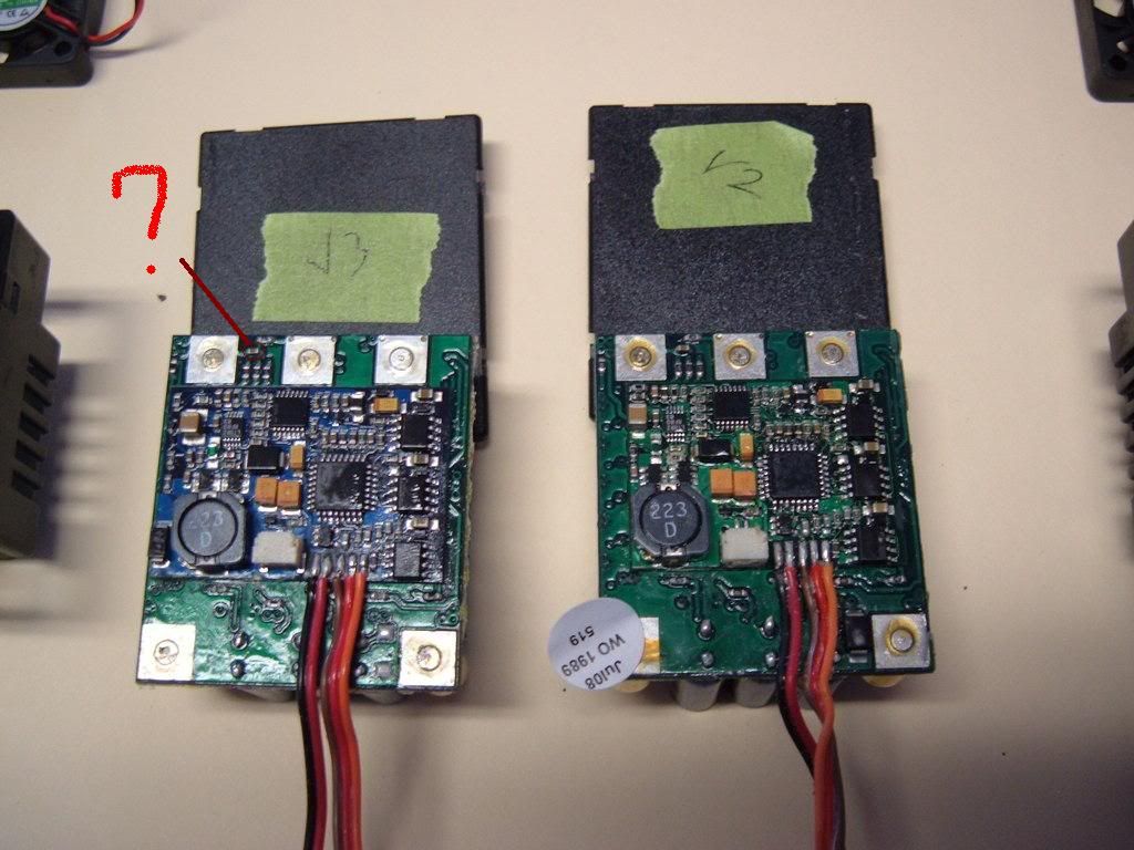

Well after a crash MMM case broke.
After little inspection I saw the pcb is missing a little smd cap? But anyone which value the cap has? Thanks for help.

.1uF 50V 0603
BUT -- it's EXTREMELY difficult to solder on that circuit board -- it's very very heavy copper and requires specialized equipment.

After a another inspection.
The black smd component (what kind of component is this) fried.
This maybe caused by the dented 390uF 35V caps?
