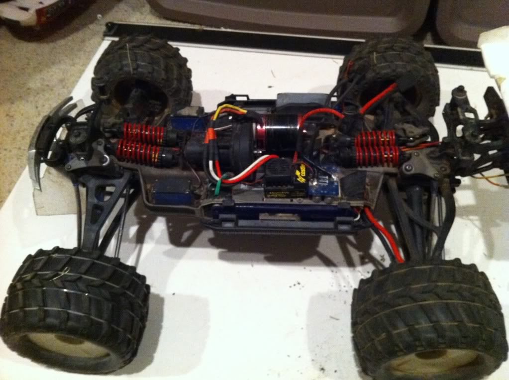

I just dusted off my MMP.... my MMM is at Castle, and I'm still waiting...
MMP in a ERBE, running 6s to a outrunner motor. I also added the offshore electrics cap bank to the esc. I raised the BEC to 6.5 volts, so far its been working pretty good. I've got some cogging isssues when starting from a dead stop, but if I keep momentum it'll go anywhere.

how do you raise the BEC rating?

Nearly all ESC's have a BEC... the rating is determined by how it is made... it cannot be raised (just buy ESC with higher rated BEC).

Times have changed! I know the MMP and XL2 esc's have an adjustable bec via the castle link. I believe the MMM with the newest firmware is also adjustable? I'm not sure on the MMM, but I do know Castle can adjust the MMM's bec while at their facility. Adjustable voltage, fixed amperage.

Yup, my MMP can change the BEC voltage through the castle link software.
