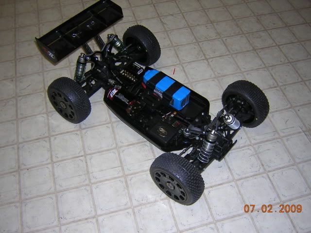

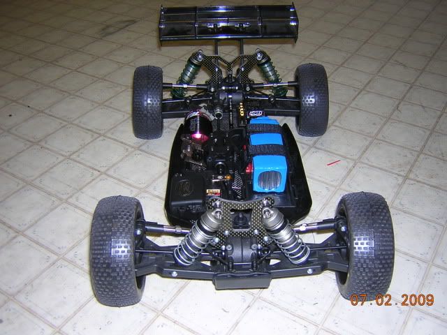

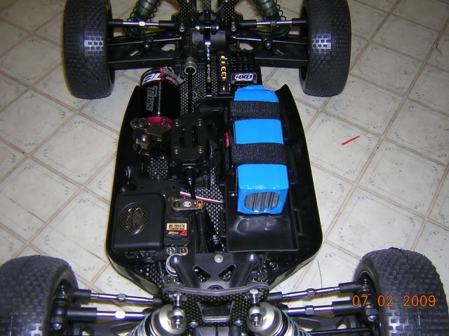

this has been a long and expensive project but we are finaling getting to the light at the end of the tunnel
i know you guys didnt come here to read, so here's some highend buggy porn

Very nice indeed!!! Do you have any pics from under the frame?
