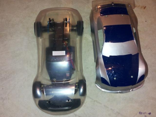

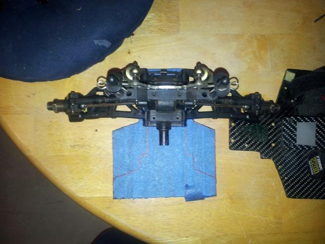

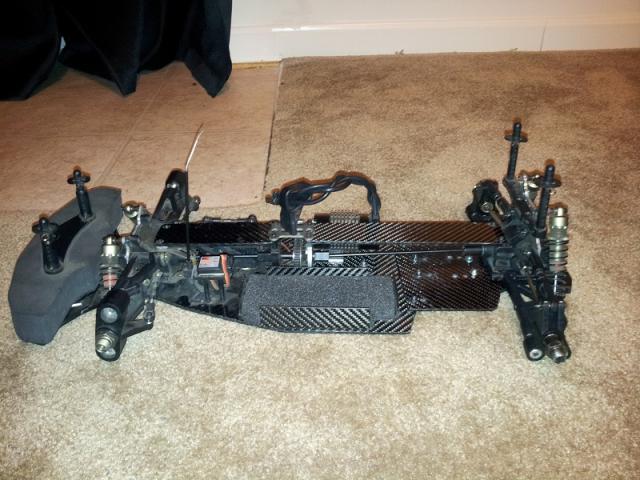

After being a little disappointed in the over all look of my OFNA GTP2 for a length to with perspective, I decided to take the scale out to a 1/7th scale wheel base. Basing my measurements on the Traxxas X0-1, I fabbed up a carbon fiber extension plate to move the rear section of the car back nearly 3 inches. The wheelbase is now exactly 15.9 inches from center front to center rear and the perfect length to fit the X0-1 body. Just as with the rest of the chassis, the extension plate and the top plate is 4.4mm carbon fiber.
After getting it all back together the fit and finish could not be better. After a few tweaks to the GTP mounting posts, the body went on without a hitch and the road test was a success. The first of two projects down, one to go.

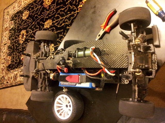

I took the extended GTP beast out for a test and tune session, working to dial in the steering and handling at high speeds as well as the aero principles of the XO-1 body and came to realization that I might be over geared for the Castle /Torx 2200. I initially had it geared at 24/51 and after about 10 minutes of running, I got the single red LED on the controller and no further movement. Batteries were warm, motor was less than warm but the fan was running. Re-geared to 20/51 on the same motor and pretty much got the same result after a few more runs, so I decided to swap out the Torx 2200 for the 1717 in the Mayhem 2.0. Still geared at 20/51...I hope to get better runs out of this combo. Here is a pic of the beast with the new motor.

Hmmm... the 2200 should have no problem spinning those gears.
I would check all the bearings and make sure of a bind free driveline.
