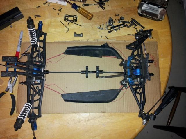

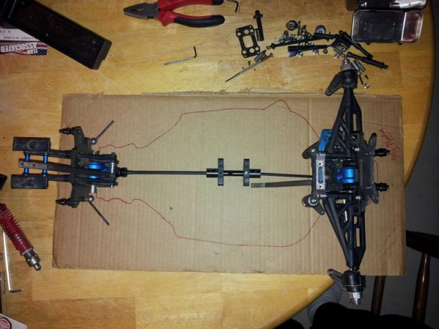

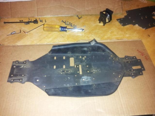

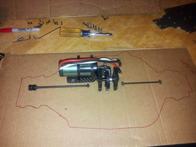

I was looking over my growing collection of cars and trucks and I felt it is time to rebuild, bigger, better and badder (I know that is bad grammar) First up is full carbon conversion to my Mayhem Truggy. Ditching the metal chassis for a custom 4.4mm carbon fiber chassis. Also replacing the center diff with a ofna center spool. Front and rear shocks have been upgraded to 16mm big bore units and the shock mounts have been raised to lower the stance about an inch. I got a chance to get the Mayhem down to the frame and a few shots of the template.
