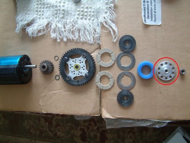

If so, I still face the issue of the front pressure plate. In images I've seen of Strobe Slippers (such as the one below), I keep seeing a part that I do not have, was not included with the Strobe I bought. I have everything except the part circled in red (which is basically the front pressure plate that sandwhiches the rubber spacer against the slipper).
Does anyone know where I can find one of these? Is this a part that is original to the Strobe?

I hope you didn't pay much. You are also missing the blue ring (basically a rubber ring). It was the combination of the missing plate and missing blue ring that made the slipper what it was. Those two parts spread out the pressure on the slipper, instead of having all the pressure centered on the little spring. More even pressure made the spur gear run more true.
I'm sorry to say, but I think you are SOL. Both because of the missing parts and the fact that they are just two different designs of slipper, I don't see the strobe working on a 3903 trans.
Also, the strobe was an upgrade to the 3906 (you know this). The 3903 has a "revo spec" slipper that is just as good, or better than a strobe.
It's kind of a pointless upgrade, I'd actually consider it a downgrade.

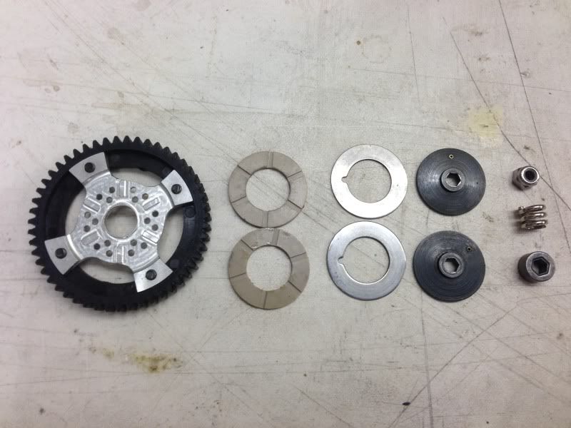

Anyways, UE never made a nut or sprong, UE just sold stobe parts in UE packages. I attached pictures of some of my strobe parts in UE packages.
I have seen the strobe slipper assembled 2 different ways, one with the sprong and one without. I attached pics of both ways. If the sprong isn't used the stock traxxas spring is used instead. I tried to capture this on my Gmaxx in the pictures, hopefully you can see it. Im not going to say what is better or if it is even good, I have a few, but have never used one myself on a truck I run.
I have made my own sprongs and you can see them in the last pictures. I contacted the originally creator of the strobe parts and asked him for permission and questions on materials. I then made them and had Miratlhed test one out on his lightening after he proved that the rubber pluming gromet that a lot of people tried to use in place of the sprong didn't hold up and melted. He said that mine worked just as well as the original sprong and he has a video of it and all on the UE forum. My original intention was to make them and sell them to people that needed/wanted them, but no one ever seemed interested. I also made a prototype of the adjuster nut, but quit progress on it after there was no interest in the sprongs.
Here are some pics

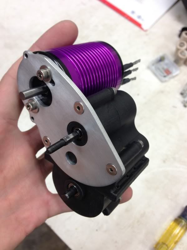

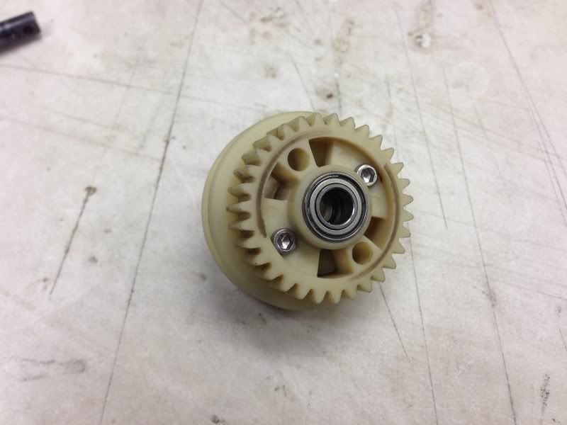

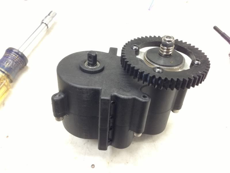

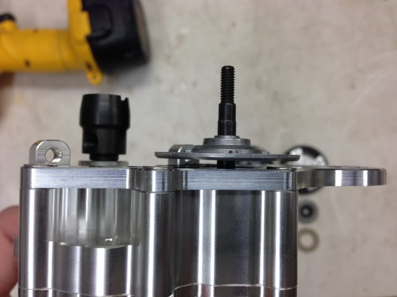

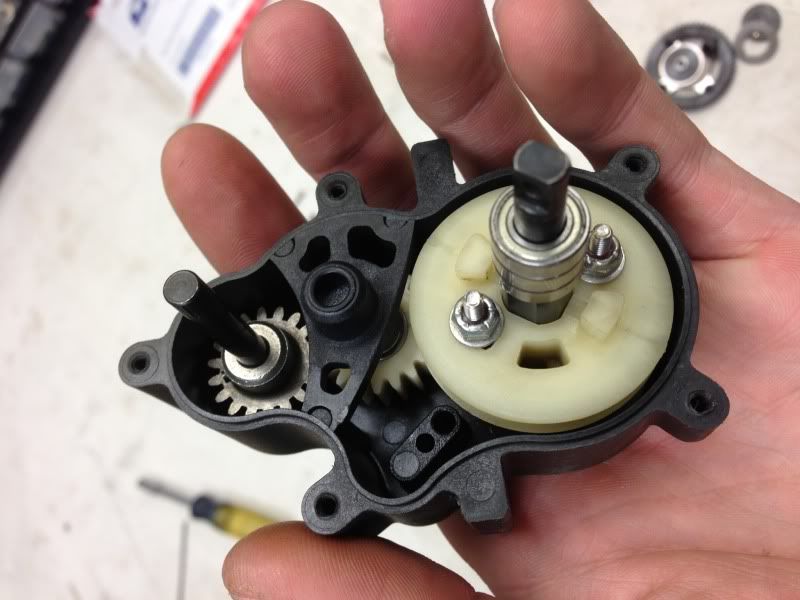

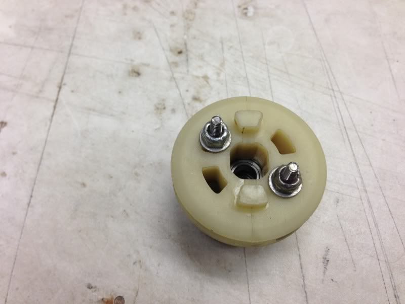

12.09.2012, 03:45 AM

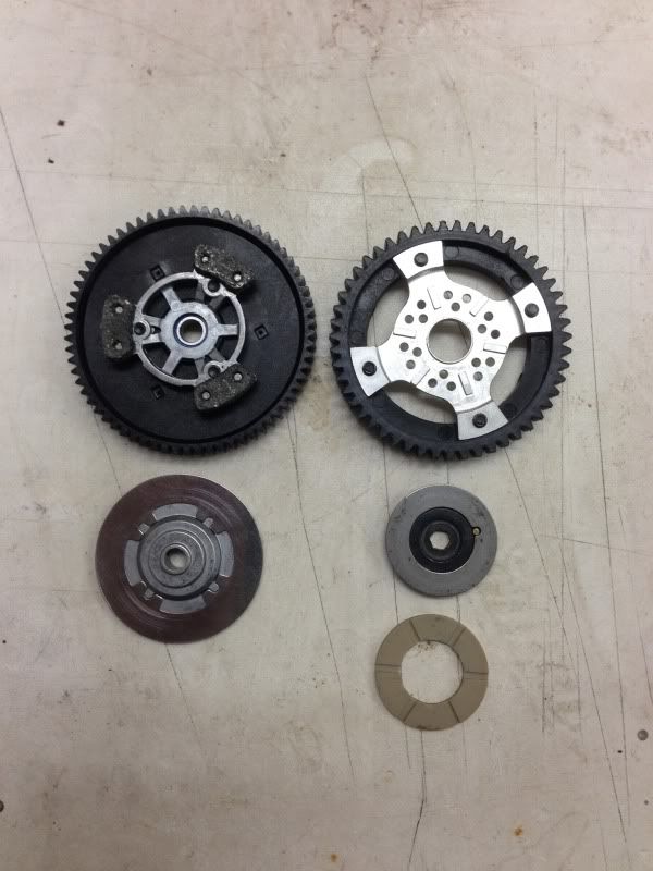

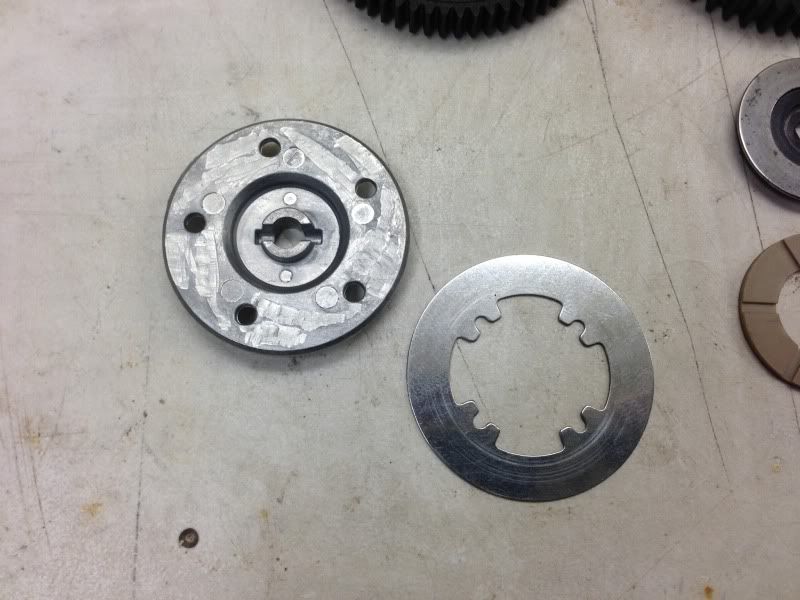

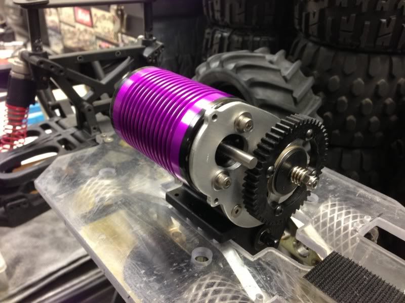

Well, having never owned a newer Maxx or Revo, my knowledge on the size of the slipper parts was non existent, so I had to just buy one and see.
As mentioned earlier, I snatched a complete 3903 setup on the bay for $22 shipped, and what I found after comparing the two setups pretty much killed my idea dead in its tracks, as you can see the slipper plates are very different in size. So my plans of using the newer style rear pressure plate with the strobe is a no go.
So I'm going to use the new slipper on my 3903, and the strobe on my old 3906 maxx that I'm beefing up and converting to brushless.
Since my FLM motor plate on my 3903 is thicker than stock, I had to remove the fins on the back of the new rear pressure plate in order to clear the motor plate screws and so the fins didn't drag on the motor plate.
I locked my old 3906 trans in 2nd gear in preparation for the Hacker.
I still need a steel idler gear for it though.
And I would like to have a sprong and UE nut for the strobe.
Then cut down an old dual motor plate.
So, even though I kinda messed up when I bought the strobe for my supermaxx build, I still managed to make things work...got a complete setup for both trucks.
-Travis
