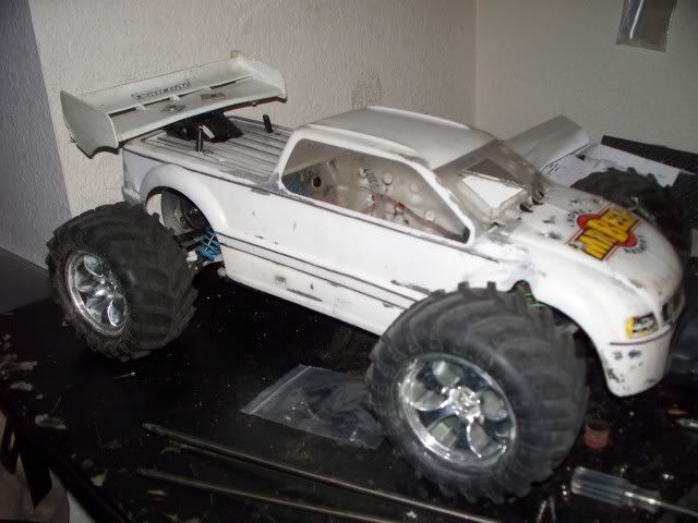

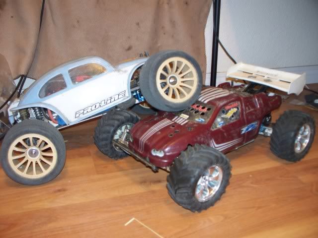

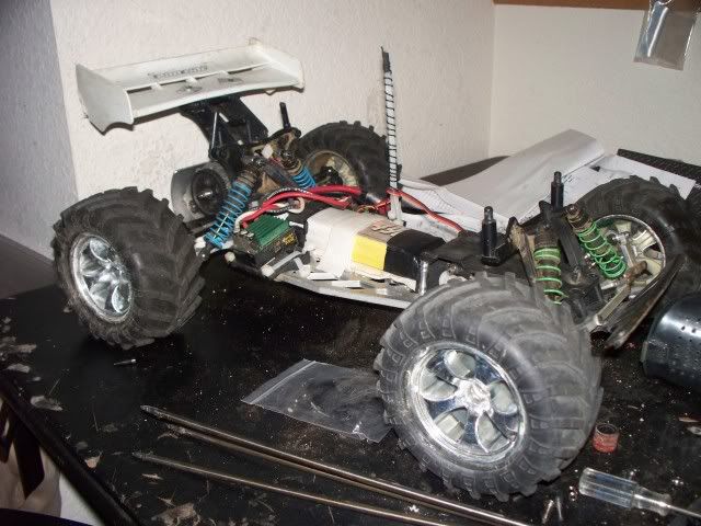

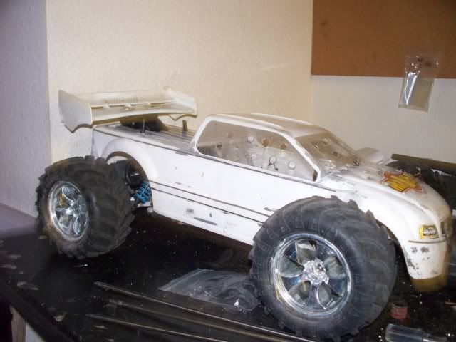

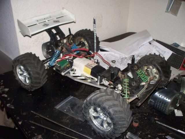

Here is my old Rustler that I beat to hell and upgraded to no end before I realized the benefit of 4wd. So after a year of the rustler sitting and me making my GF tag along on bash sessions. Of course, she always ask to drive for a bit, I decided it was time to dedicate the rustler to her... here it is sitting now. Almost ready to roll. It can be used, but with the stock Traxxas radio, it glitches and cogs so badly. It is un-usable. So I will be getting the HK $30 2.4gh Radio for her.
It has FLM Extended chassis, EXT. Arms Front and Rear, C-Hubs. RPM Shock Towers. 20Kg-Cm MG Servo. Raze Wing mount. Mugen wing. 3905 E-Maxx Body. 2.2" Masher 2000's Stretched onto 3.0" Proline 30 series rims. Traxxas BB Shocks /w hard springs special mounted in the rear to lay down farther. MM Velineon and 3s Zippy 4900. YEAH A HANDFUL FOR HER. She will need a lot of practice. (My GF)

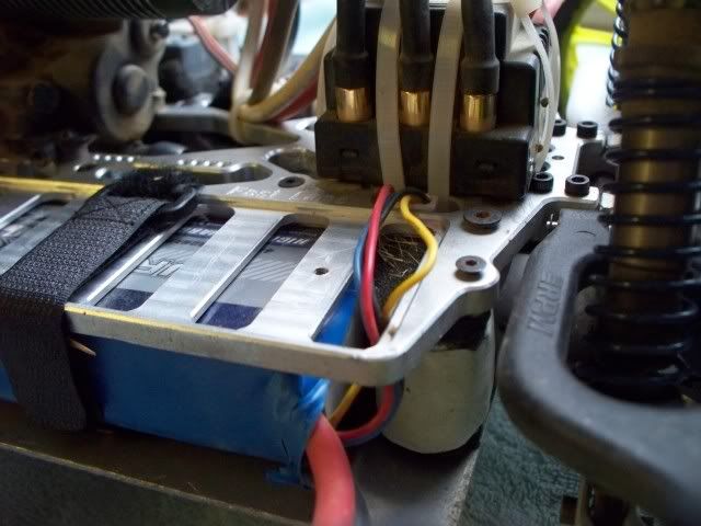

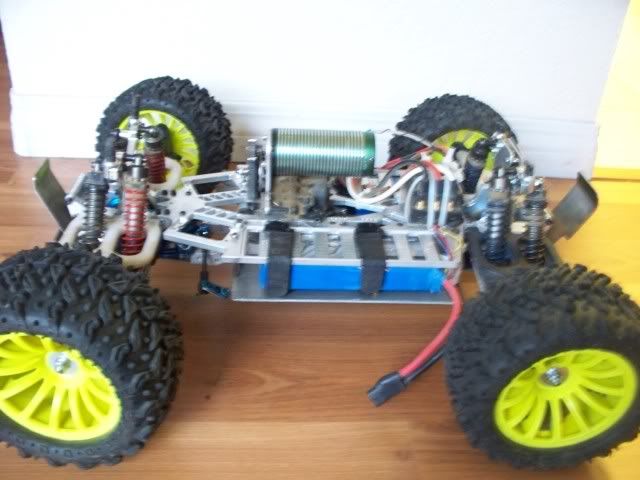

I've got some: FLM Chassis RPM Upper arms FLM Lower arms, Traxxas CVDs, LST2 Diffs, UE Towers (Braced in rear, also setup for wing if need be) MMM-1520, 6s Turnigy 5k, mounted below chassis with custom center skid to protect batteries, also FLM Skid. Custom rear toe links from 1/8 buggy. 17mm hex, steel washers,for shocks I have 4 RC8 fronts and 4 OFNA Rears with UE Springs. HCR Ti Skids w/ RPm covers. Hitec 7950TH Servo And GH Steering Setup. Maybe more...
Pics: First Thanks Castle! GREAT SALE!!! This 1520 is HUGE compared to the Medusa 36-70-1600 (Medusa never broke 155* but it'll be a backup).

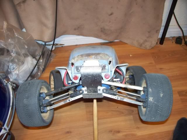

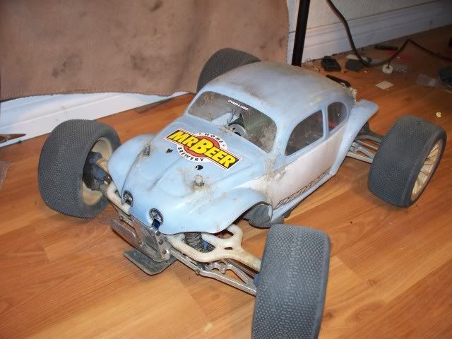

I've setup the suspension about as maxed out as possible. But with pretty soft springs, It weighs about 12.5 pounds depending on tire combo. So it sits nice and level sitting down; Sags on take off, but takes the bumps very well even at 30mph...
Also I have installed LX-1E Rear upper arms with Lunsford Ti turnbuckles. Broke about 15-20 Stock Rod ends and not one of these yet....

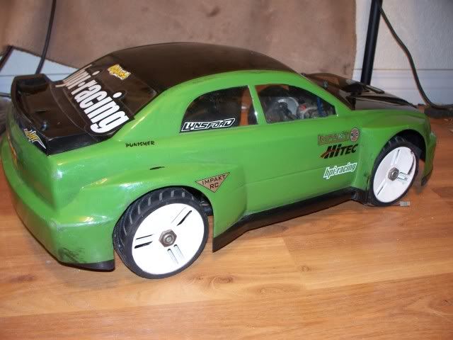

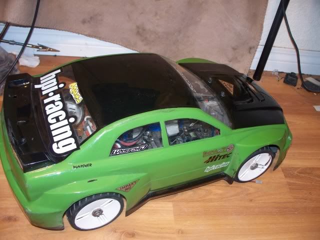

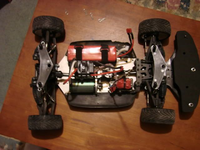

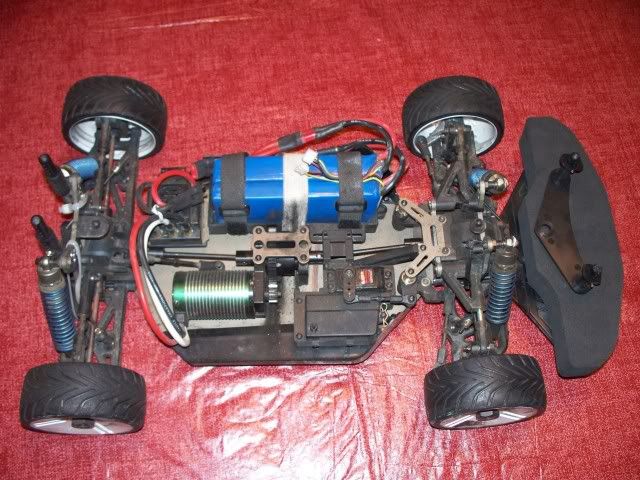

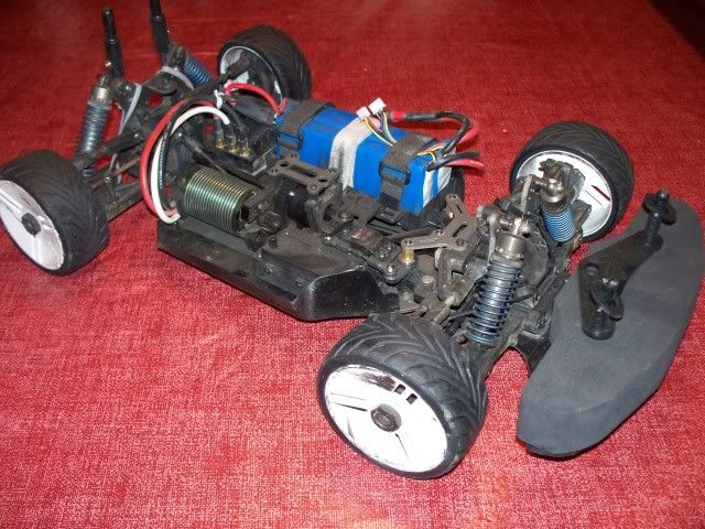

Next on the list is the BUGGY! The best handling of the bunch and I think most versatile. Lowered For Street and Jack the Suspension and it gets more air than the MAXX!!! Here she sits now, all setup for On-Road bashing.
Me and My dad setup our 1/8 Buggies for Road Bashing (Rashing>???). With the CD PACKED with 10k it gets this sucker drifting quite well...

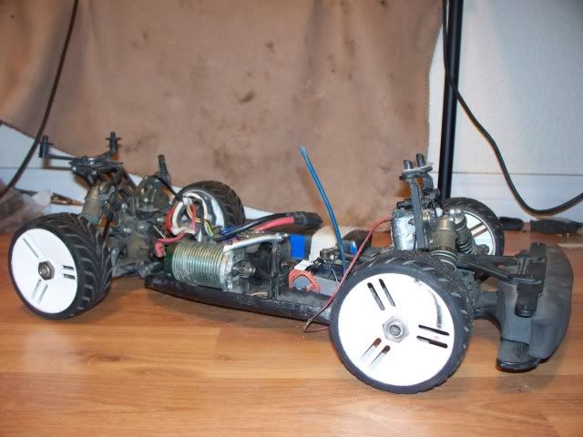

I've added a L8ight Front bumper and Foam, A Stampede Rear body mount, mounted on the wing mount. Setup is a Mamba Max (old school Edition ) 4s Turnigy 40c and CCNeu 2650kv, 14-43 gearing. GRP Rally for street tires...
Photobucket
Photobucket
As you can see I've braced the RCM Mount with 1/4" 6065 tubing, because I hit a curb so hard and actually bent the mount pretty badly, Just put it in the Vice and made it somewhat back to normal. Braced it because I fear its weaker now...
Photobucket

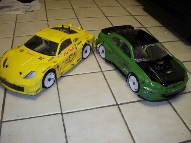

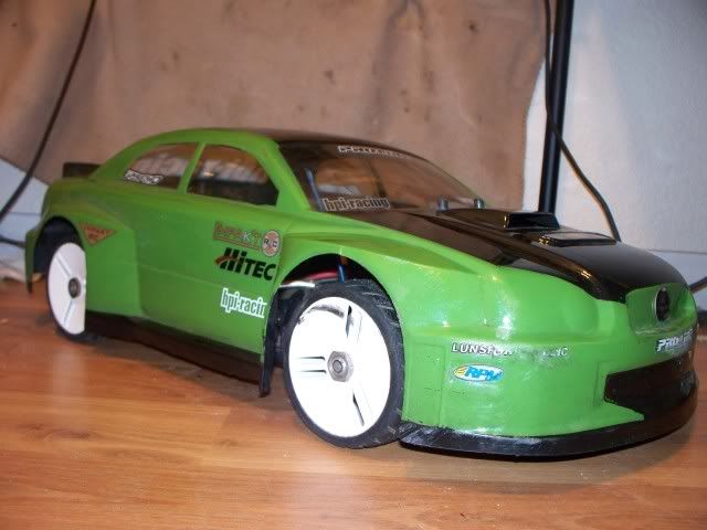

My Dad and Myself bought some Inferno GT Bodies. He Bought the 350z and I bought the WRX.. It makes it so much more fun watching these things scream by at 45-60mph. Just Realistic watching the body roll a bit into the drifts...
Photobucket
Photobucket
Photobucket
Photobucket
Photobucket

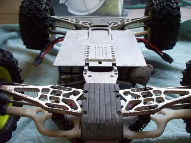

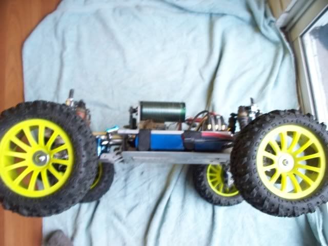

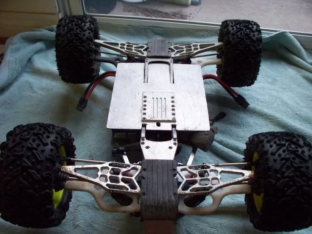

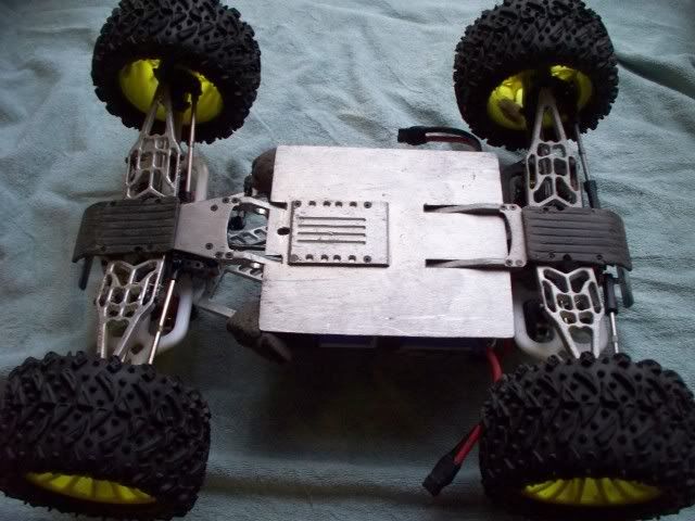

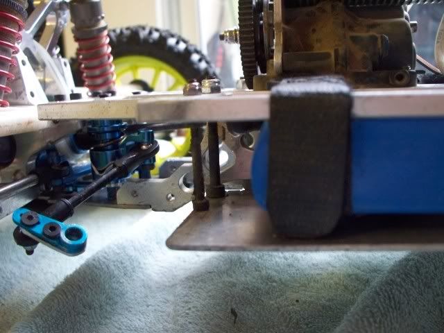

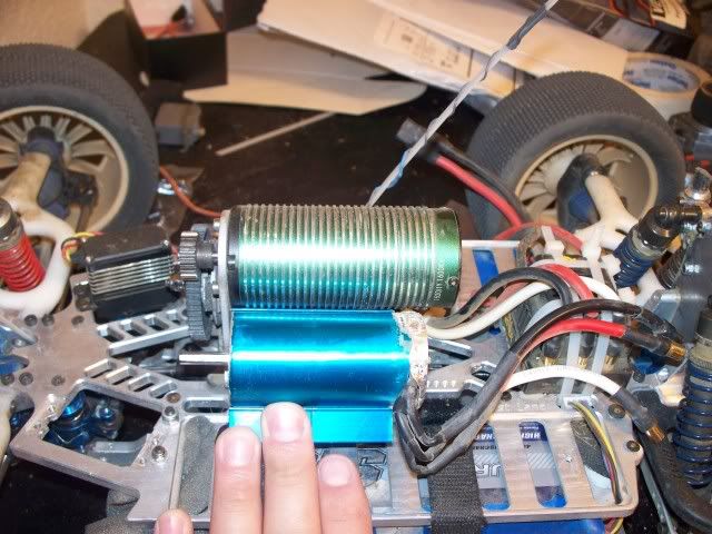

As promised in another post, here is my Maxx Skid Plate. VERY Simple: 7075 1/8" inspired by a CF/FLM Build I saw here about 2 years ago. Although the bottom is just a skid and I strap the batts to the bottom of the chassis.
Photobucket
Photobucket
Photobucket
Photobucket
Just using the holes tapped from the FLM Chassis, Used 40mm - 3mm and 4mm screws and lock nuts to keep it from bending. wrap it in foam, and done.
Photobucket
Photobucket
Only thing I need is to get that motor lower. Possible CD when $ presents itself. Also, These are my favorite tires, Zombie Maxx. I Stretched them onto so Rulux HalfUps with some Ofna Soft MT Foams. They are about 2 years old and at least 50% tread left and they are SOFT compound.

Looks great! Where is your servo?
The tire and wheel combo look great!
ZippyBasher
8th scale Stunt-Driver/Mechanic
ZippyBasher's Avatar
Posts: 441
Join Date: Dec 2008
10.22.2010, 12:20 PM
Thank You! Servo had to be repaired. It sits in the normal spot.

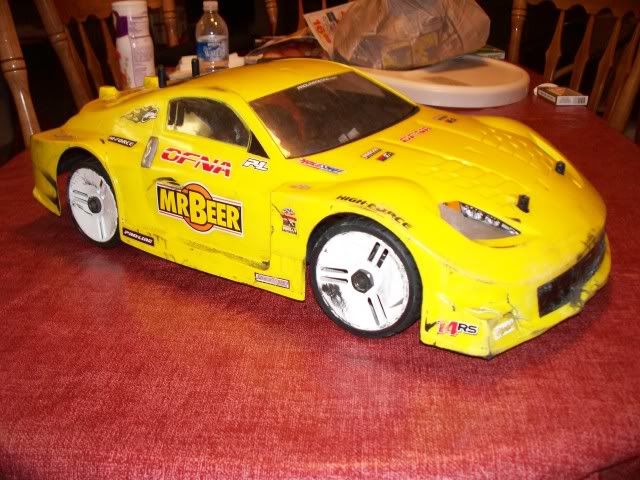

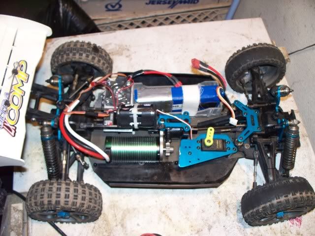

Here are some shots of my dads buggy. I have been asked for pics of his car on a couple other posts... He has an LX-1E and ordered GTP Body mount kit and GTP front bumper and Foam. And of Course GRP tires and an Inferno GT Body: 350Z So much fun!!! He has 5s on the 2650 and it is FAST!
Photobucket
Photobucket
Photobucket
Photobucket
WRX vs 350Z
Photobucket
^^ The LX I have been helping my Brother in law build... Still a work in progress... Its got a 1518 in there!

You and your Dad's on road cars look a lot like my on road conversion...mine is a MBX-5 running a 2200 cc motor on 5s. I actually have added Revo shocks front and rear to stiffen suspension conciderably..just not pictured
